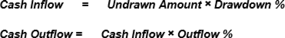

    Following is an illustration for drawdown:
    This illustration shows the formula for drawdown
    Figure 7-9 Illustration for drawdown

    Here,
    Primary bucket = Inflow bucket Offset bucket = Outflow bucket
