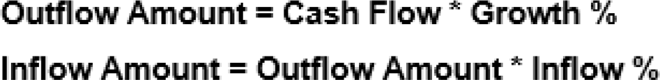

    Here,
    Figure 7-14 Formula for Asset Book Growth
    This illustration shows the formula for Asset Book Growth.

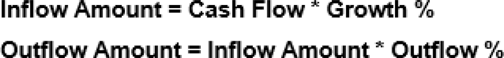

    Here,
    Figure 7-15 Formula for Inflow Amount and Outflow Amount
