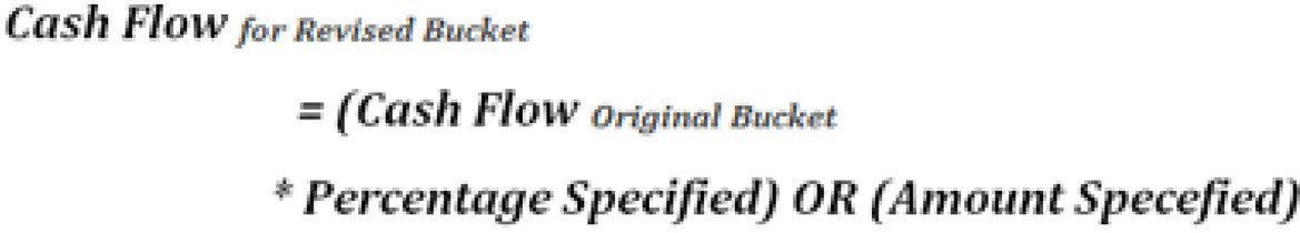

  3. If time-specific or critical obligation, record the delay and indicate a breach. Cash flow assignment is done in the following manner:
    Figure 7-2 Cash flow assignment formula
    Figure 7-3 Formula for Cash flow assignment
