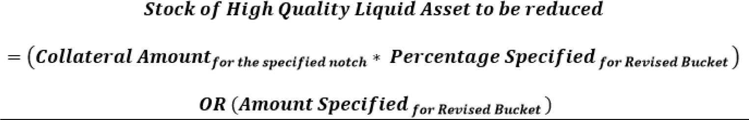

  3. If time-specific or critical obligation, record the delay and indicate a breach. New Stock of HQLA assignment is done in the following manner:
    Figure 7-8 Formula for new stock of HQLA assignment
