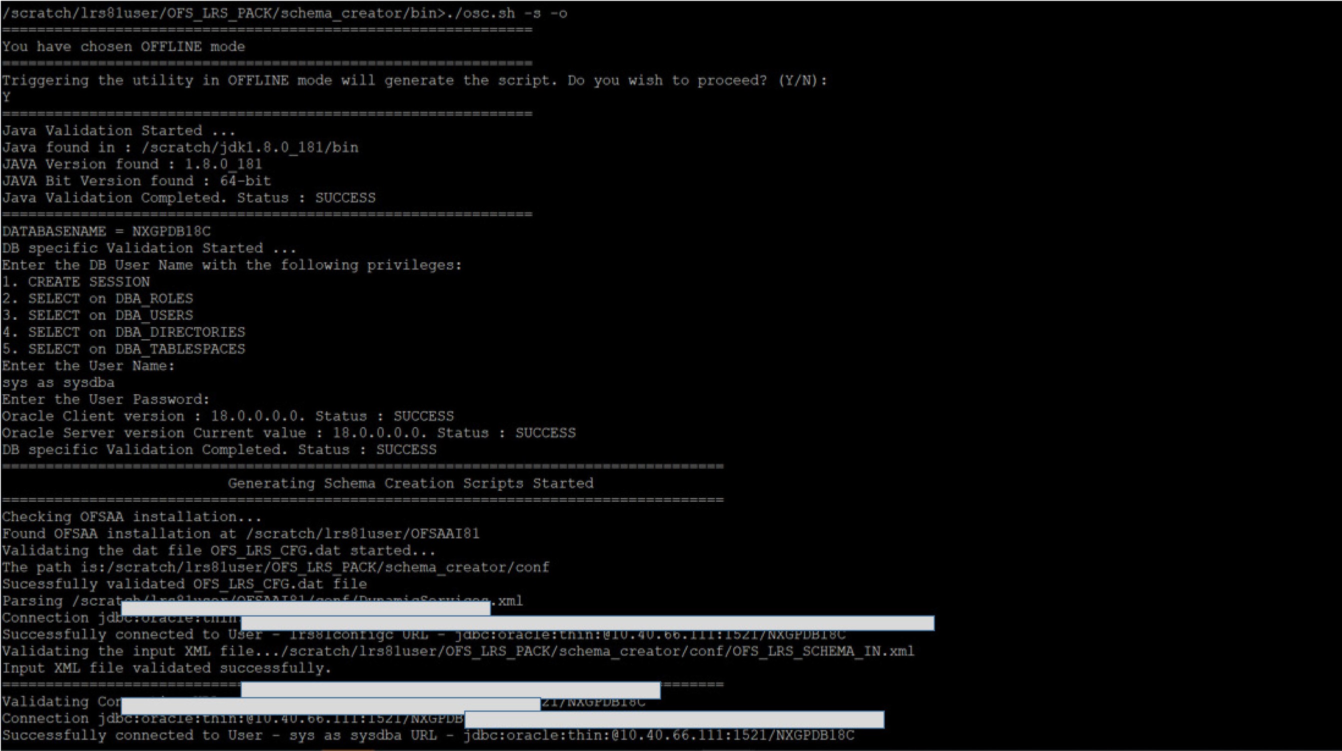

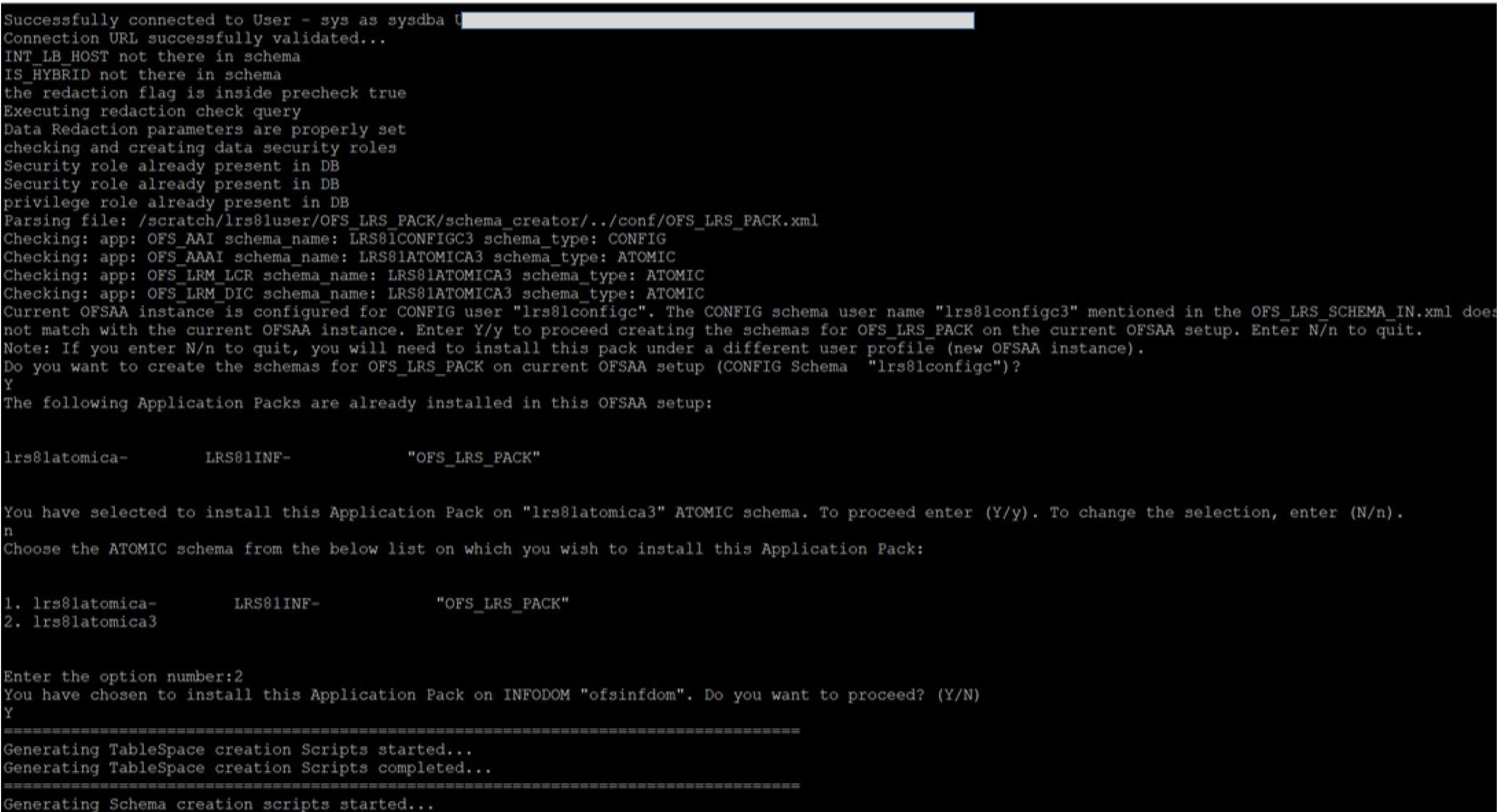

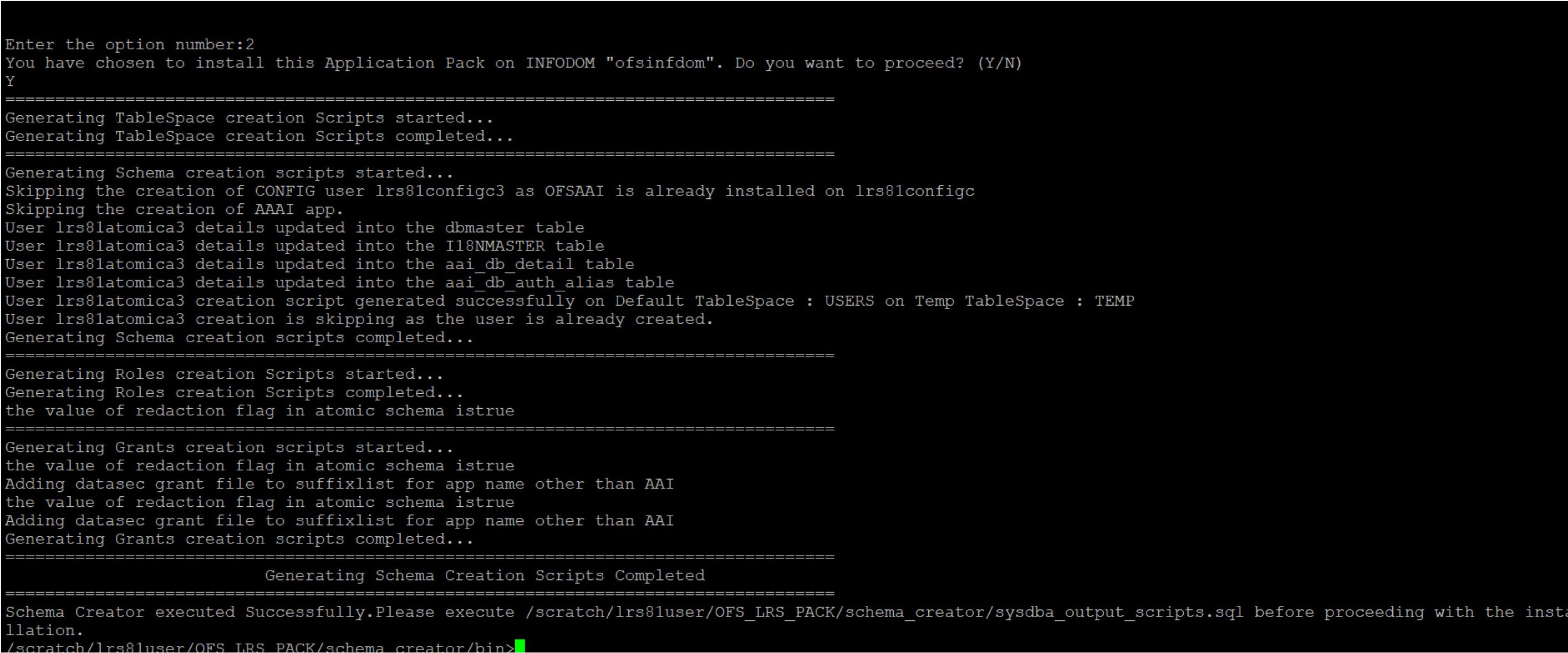

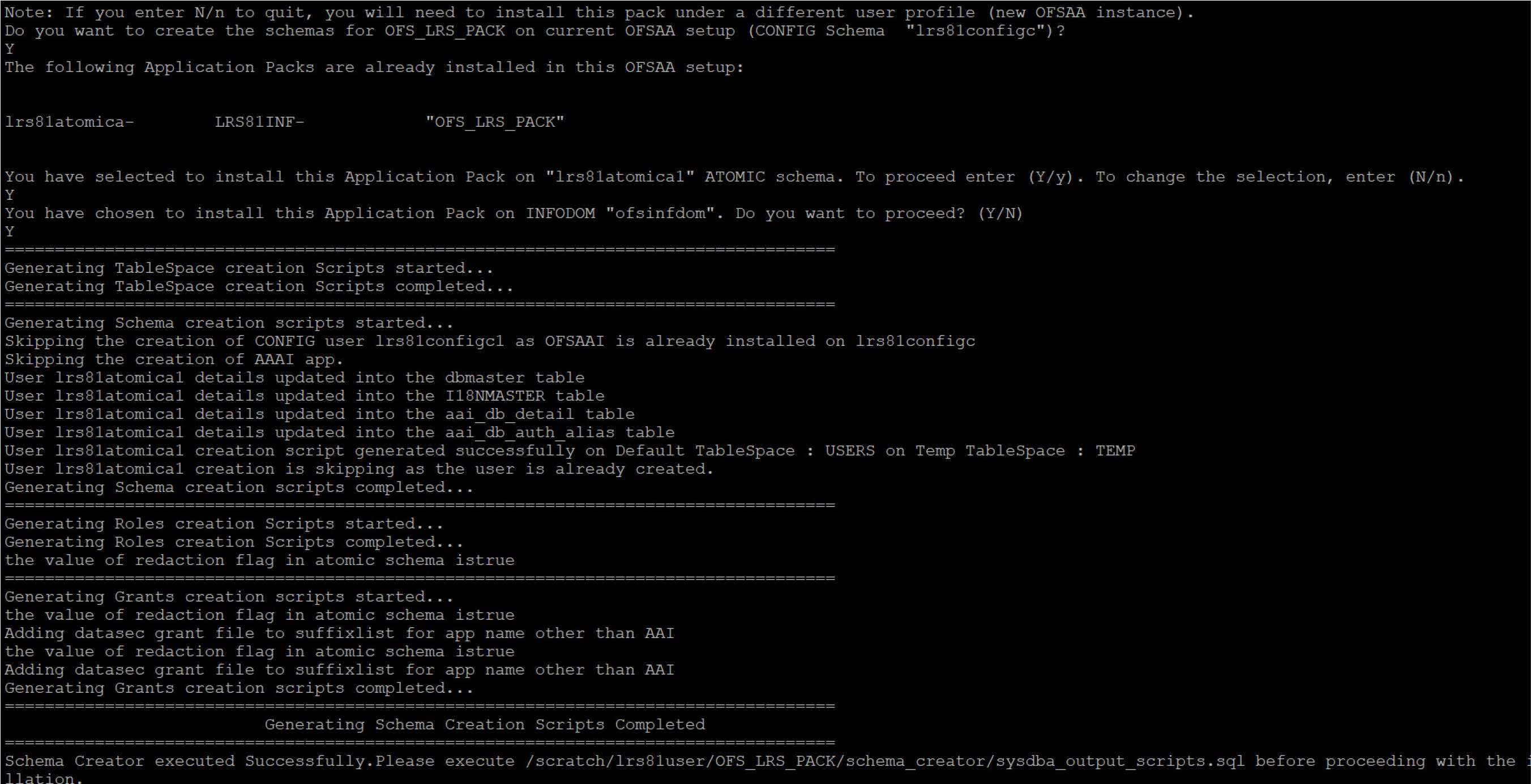

7.4.3 Execute the Schema Creator Utility while Installing Subsequent Applications Pack
When executing the schema creator utility during the installation of a subsequent Applications Pack, you can choose to install the pack either on the same Information Domain or Atomic Schema of the existing application pack or on a new Information Domain or Atomic Schema. You can execute the schema creator utility either in Online or Offline mode.
To execute the schema creator utility while installing OFS LRS Application Pack over an existing Application Pack, follow these steps:
