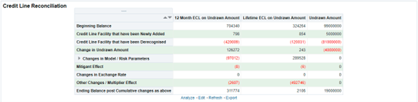

Credit Line Reconciliation Report
In addition to the preceding report, the reconciliation feature also caters to the quantitative disclosure requirements of the undrawn amount but with more details or granularity.
The report shows the roll forward of Expected Credit Loss and Undrawn amount values, from the beginning period balance, through the various parameters or values affecting the ECL and Undrawn amounts to the ending balances of the current period. The report is designed in a manner that allows you to view it in a detailed format.
The following table explains the list of reporting lines that are part of this report and the corresponding factors associated with it.

Use the ReconciliationID drop-down list filter and select a value.
For every Credit Line Reconciliation report, a unique Reconciliation ID is generated for the selected Base Run or Run1 Date and run_skey and Inspect Run or Run2 Date and run_skey.
To know the Run 1 and Run 2 details for a Reconciliation ID, execute the following script in the atomic schema:
Select distinct N_RECONCILIATION_ID,BR.FIC_MIS_DATE BASE_RUN_MIS_DATE, N_BASE_RUN_SKEY, IR.FIC_MIS_DATE INSPECT_RUN_MIS_DATE, N_INSPECT_RUN_SKEY from FCT_LLFP_CREDIT_LINE_RECON CLR INNER JOIN DIM_RUN BR ON BR.N_RUN_SKEY = CLR.N_BASE_RUN_SKEY INNER JOIN DIM_RUN IR ON IR.N_RUN_SKEY = CLR.N_INSPECT_RUN_SKEY;
Figure 13-7 The Reconciliation ID Filter
Figure 13-8 The Credit Line Reconciliation Report
