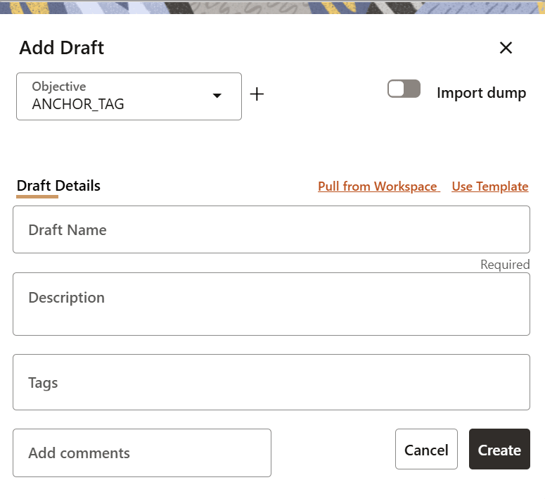

    Creating Drafts from within an Objective
    1. From the Model Pipelines list of objectives, select Draft from the Add drop-down list.
      Figure 11-79 Add Draft from an Objective
    2. Populate the following fields:
      • Draft Name: Enter a name for the draft.
      • Description: Enter a description for the draft.
      • Tags: Add tags for the draft.
      • Comments: Add comments for the draft.

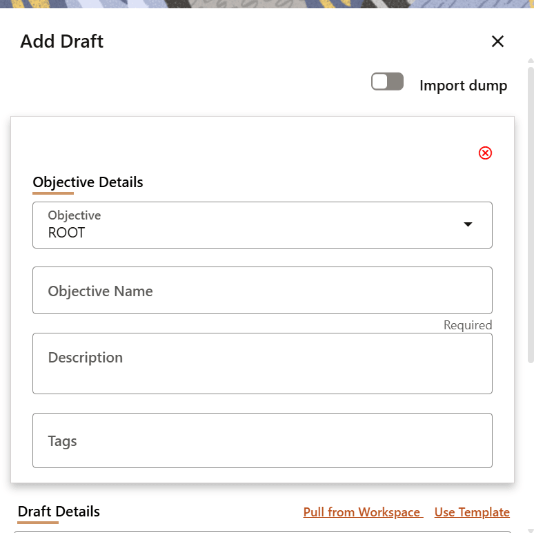

      • Create a draft from an objective
        1. Click the Add in new Objective icon, adjacent to the Objective drop-down list.
          Figure 11-80 Objective Details
          Objective Details
        2. Perform the following actions to populate the form:
          • Objective: Select an objective from the drop-down list.
          • Objective Name: Enter a name for the objective.
          • Description: Enter a description for the objective.
          • Tags: Enter tags for the objective.
        3. You can also select the Pull from Workspace or Use Template options to add the information via a selected workspace or a template.
        4. Click Create.

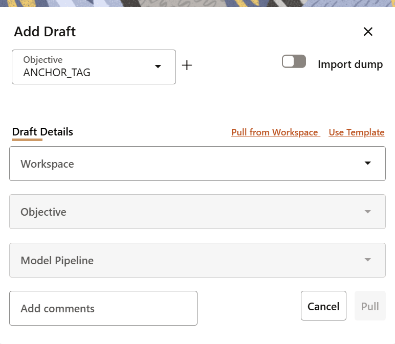

      • Pull from Workspace
        Figure 11-81 Pull from Workspace
        Pull from Workspace
        • Workspace: Select a workspace from the drop-down list.
        • Objective: This option is enabled when a worspace is selected from the Workspace drop-down list. Select an objective from the drop-down list.
        • Model Pipeline: This option is enabled when an objective is selected from the Objective drop-down list. Select a model pipeline from the drop-down list.
        • Pull: Click this option to pull all the selected details from the workspace.
