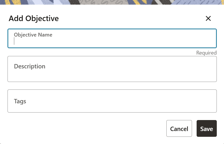

  4. Enter details in the Name, Description, and Tags fields.
    Figure 11-76 The Add Objective Window
  5. Click Save.
