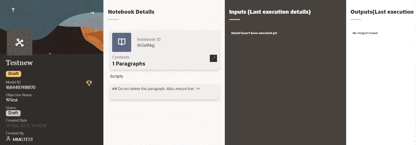

  3. Click next to corresponding Model and select Scope Detail option. This is available for both Draft and Published models.
    The details such as Notebook, Inputs (Last execution details), Deployment Details, and Outputs (Last execution outputs) are displayed.
    Figure 11-119 Scope Details
    This image displays the Scope Details.
