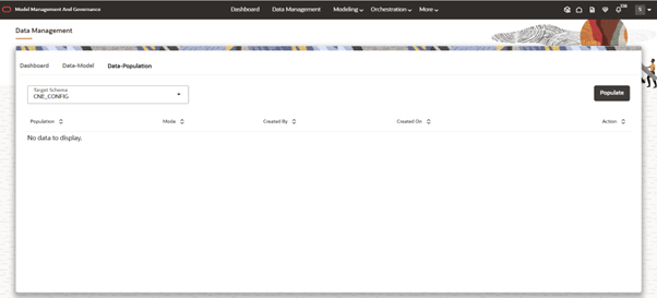

Data Population tab

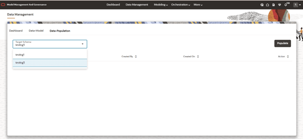

Figure 9-16 Target Schema selection and populate button
This image displays the Target Schema selection and populate button.
Target Schemas dropdown
  • It will show list of Target Schemas mapped to current workspace.
  • We can select any Target Schema, by default 1st one is selected (The one which is selected firstly in workspace creation step 2).
  • By choosing one schema, it will show the list of data populations that are created as a table.
Populate button
  • This button helps to create a new Data Population.
  • By clicking on this, user will be taken through few steps for creating a Data Population.

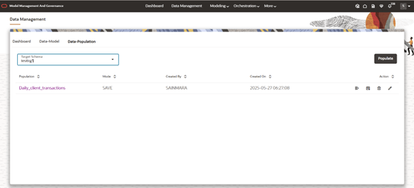

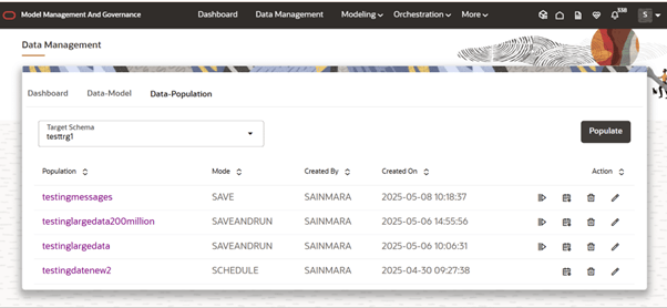

Data Population List
  • This will show the list of populations that created for the selected Target Schema (From dropdown).
Figure 9-17 Data Population List
This image displays the Data Population List.

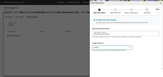

  6. Basic Information
    • Here user need to provide the basic information about Data Population Name and can choose the Target Schema for which user wants to create Data Population.
      For example: Data Population Name –> Daily_client_transactions, Target Schema –> Testtrg3
      Figure 9-21 Basic Information
      This image displays the Basic Information.

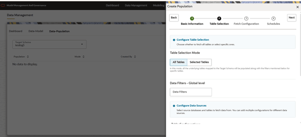

  7. Table Selection
    • This step includes tables selection mode and table filters to be seeded.
    • Table Selection
      • Table selection mode is about to refresh All tables data or Selected tables data.
      • We have two modes in this: All tables and Selected tables, where All tables fetches data for all the tables from Source Schema to Target Schema, by applying the filters. Selected tables are the ones that have been selected as part of Table Filter Configuration, for fetching data.
        All tables mean the tables that are created by using MMG in Target Schema.
        Figure 9-22 Table selection and global filter
        This image displays the Table Selection and Global filter.

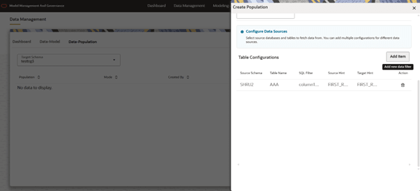

      • Table Level Filters: This filter can be applied to individual table level. Click on Add item. This will add an empty row in the table where we need to fill the details of Source schema, table name, SQL Filter, Source Hint, Target hint.
        1. Source Schema: This is dropdown where it lists the Source Schemas, which are already mapped to this Target Schema.
        2. Tables: This is dropdown, where we select a table from list of tables, this list of tables is the tables list that are selected when doing data modeling or workspace creation step.
        3. We can select more than one table.
        4. SQL Filter: This is the filter that will be applied to the tables that are selected and used while fetching the data.
        5. Source Hint: You can provide database Hints at table-level, Source hint is applied in the source schema while fetching the Data from Source.
        6. Target Hint: You can provide database hints at table-level, Target hint is applied in the Target Schema while doing the inserting Data to Target.
          Figure 9-23 Table Level Filters
          This image displays the Table Level Filters.

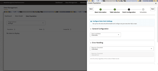

  8. Fetch Configurations
    • This has mainly three configurations:
      Figure 9-24 General Configuraitons and Error Handling
      This image displays the General Configuraitons and Error Handling.
      1. General Configurations
        • It has data load mode dropdown, where we have two options: Overwrite and Append.
        • Overwrite mode: In this mode, the underlying tables are truncated (overwritten on existing data) followed by an insert operation.
        • Append mode: In this mode, the underlying tables will be populated (added to the existing data) in the append mode.

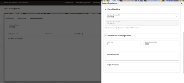

      2. Error Handling
        • It has Rejection Threshold configuration, whereby default it is set to Unlimited. So Here, all the errors will be ignored during the data population.
        • We can also set a custom rejection threshold, for this we need to change the dropdown value to Custom Rejection Threshold, which in turns enables the input box for giving custom value. You can provide the maximum number of inserts that can fail while loading data to a given table. In case of threshold breach, all the inserts into the table will be rolled back. However, it will continue populating to the next table.
      3. Performance Configuration
        • This consists of Fetch Size, Batch Commit Size, Source prescript, Target prescript.
        • Fetch Size: Enter the Fetch size of JDBC properties for data upload. By default it is set to 10. Therefore, every time it fetches 10 records from the available records.
        • Batch Commit Size: Enter the Batch Commit size of JDBC properties for data upload. By default it is set to 1000.
        • Source Prescript: Enter the source prescript of JDBC properties for data upload.
        • Target Prescript: Enter the target prescript of JDBC properties for data upload.
          Figure 9-25 Performance Configuration
          This image displays the Performance Configuration.

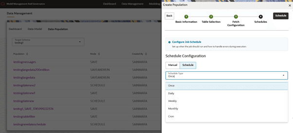

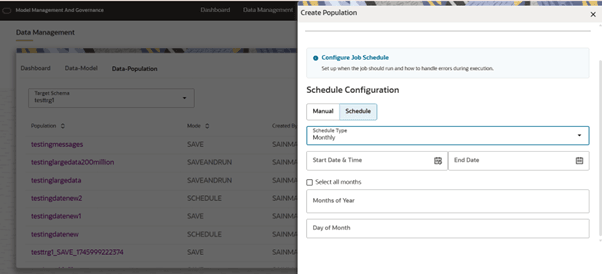

  9. Schedules

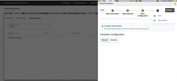

    1. We have two options Manual and Schedule, when Manual is selected Populate button at the right acts as drop down and gives two options SAVE and SAVEANDRUN.
    2. Save Mode: In this mode, after filling all the details we will save this configuration. This population can be run manually from the data population lists screen.
    3. Save And Run Mode: In this mode, after filling all the details we will save this configuration and run the population once. This population can be run manually from the data population lists screen.
      Figure 9-26 Save and Run option
      This image displays the Save and Run option.

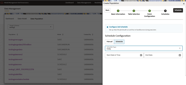

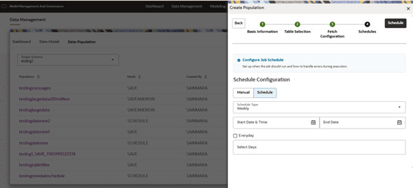

    4. If the selected mode is SCHEDULE, then we need to choose whether we need to bring data Daily/Weekly/Monthly/CRON.
      1. Based on mode we need to fill in few details.
      2. DAILY: We need to configure Start Date, End Date and Time when schedule should run daily.
      3. WEEKLY: We need to configure Start Date, End Date, Time and Days of week when schedule should run.
      4. MONTHLY: We need to configure Start Date, End Date, Time and Months of year and day of the month when schedule should run.

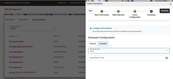

      5. ONCE: We need to configure Start Date and time when schedule should run.

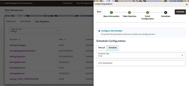

      6. CRON: We need to give a CRON Expression.
    5. Once after giving the information then we need to click on populate.
      Figure 9-27 Schedule Type options
      This image displays the Schedule Type options.
      Figure 9-28 Schedule Daily options
      This image displays the Schedule Daily options.
      Figure 9-29 Schedule Weekly options
      This image displays the Schedule Weekly options.
      Figure 9-30 Schedule Monthly options
      This image displays the Schedule Monthly options.
      Figure 9-31 Schedule Cron Expression
      This image displays the Schedule Cron Expression.
      Figure 9-32 Schedule Once options
      This image displays the Schedule Once options.
Data Populations List Action buttons
There are Actions associated to every Data Population based on mode (SCHEDULE, SAVE OR SAVEANDRUN).
Common Actions
  1. DELETE: When user click on this, it deletes the Data Population.
  2. EDIT: This option will open a drawer and enables users to edit the data population information which consists of Table level filters, Global filters, Table selection mode, General configuration, Error Handling, Performance Configuration.
SAVE or SAVEANDRUN Mode Actions
  1. RUN: We can Run the data population which is already configured. When we click on this the data population is triggered.
  2. SCHEDULE: We can schedule a data population which is created in this mode. We convert the manually triggered data population to Scheduled one.
SCHEDULE Mode Actions
  1. RESCHEDULE: This option enables the user to re-schedule already existing scheduled data population.
    Figure 9-33 Data Population List Actions
    This image displays the Data Population List Actions.
