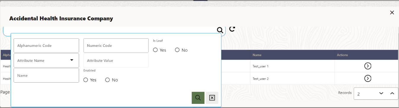

    Figure 4-3 Copy Attribute Assignment Window
    Click Search (search_icon) button to search for a specific Member based on Alphanumeric Code, Numeric Code, Name, Description, Enabled status, Is Leaf status, Attribute Name, or Attribute Value. You can also enter any of these parameters as Keywords in the Search field and click Search ().
