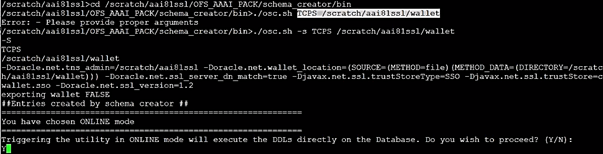

File for the values that you must modify in the XML file. - Execute the utility with the -s option.
./osc.sh -s TCPS <WALLET_HOME>
For example:$ ./osc.sh -s TCPS /scratch/oraofss/wallet

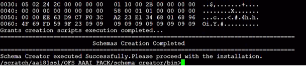

Figure 6-4 Schema Creation in the TCPS Mode
The following message is displayed:
Triggering the utility in ONLINE mode will execute the DDLS directly on the Database. Do you wish to proceed? (Y/y or N/n).
- Enter Y to proceed.

- After Schema creation is successful, proceed to Configure the OFSAAI_InstallConfig.xml File.
Figure 6-6 Schema Creation in the TCPS Mode
