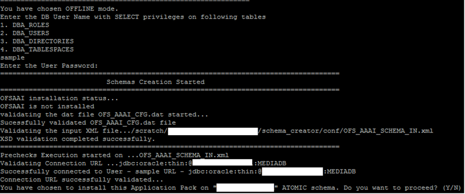

./osc.sh -s
Figure 6-7 Schema Creator Utility
You must use the same config schema user name as the previous application pack. - The utility identifies the application packs that are already installed on the
current OFSAA setup and displays the following on the console:
- Atomic schema of the existing application pack
- Information Domain Name of the existing pack
- List of installed application packs
- Select the Atomic User on which you want to install the application pack.
Figure 6-8 Select the Atomic User
On successful execution of the Schema Creator Utility, the console displays the following status message: Success. Please proceed with the installation.
