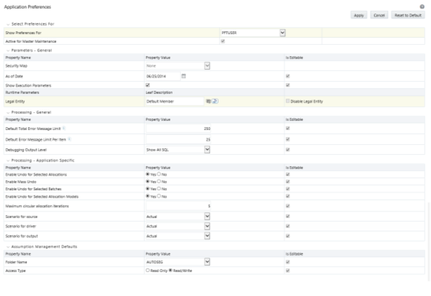

- Maximum Circular Allocation Iterations: To omit an infinite loop of allocation rules, Allocation Models are governed by an overall limit on the maximum number of iterations or cycles that can be run before the circular part of a model completes. This maximum number of iterations is set in the Application Preferences for Profitability Management.
Figure 14-4 Allocation Preferences

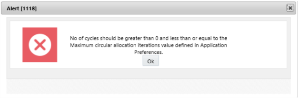

Within the specification of an Allocation Model, if you attempt to save a model using a value for the Number of Cycles that either:
- Exceeds the value found in Application Preferences.
- Is less than or equal to zero.
In such a case, the user interface displays an error message:
Figure 14-5 Error message
