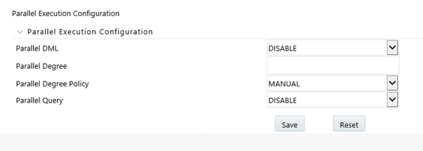

12.2 Parallel Execution Configuration
To configure Parallel Execution, follow these steps:
- Select Profitability Management from the LHS menu, select
Configuration, and then select the Parallel
Execution Configuration.
Figure 12-2 Parallel Execution Configuration
- Select a relevant option for Parallel DML from the following:
- Disable
- Enable
- Force
- Enter a value for Parallel Degree. This field accepts an integer between 0 and 99.
- Select a relevant option for Parallel Degree Policy from the following:
- Manual
- Limited
- Auto
- Select the relevant option for Parallel Query from the following:
- Disable
- Enable
- Force
- Click Save to save the configuration.
For more information, see the Profitability Management Parallel Execution section.
