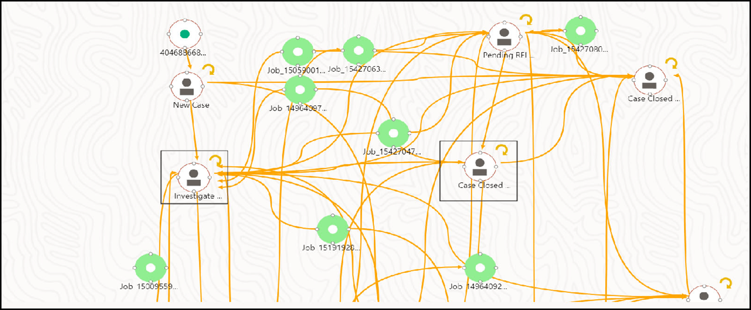

  3. Select Common Tasks.Click Process Modelling Framework. Select Process Modeller. The Process Modeller page is displayed.
  4. Select Case Management - AML. The Case Management - AML page is displayed.
    Figure 6-2 Configuring Multiple Reports in the Single Instance
  5. To add another Report (template - US SAR or CS STR), double-click on Investigate, an Investigate Case window is displayed.
  6. Click Transition. The existing jobs are displayed. You can select one of them or add a new transition.
  7. To add a new transition, click + Add icon. The Add New Transition Node Job window is displayed (provides the job number from which you are adding the transition).
  8. Click Connect To. Select Case Closed SAR Filed job from the drop-down list and Transition List - Job_1495627329012_Job_1495627329012.
  9. Click Save. A confirmation message is displayed. The newly added Report type (SAR or STR) is displayed in the OFS ECM Application Take Action window to take action on the selected case for resolution.
