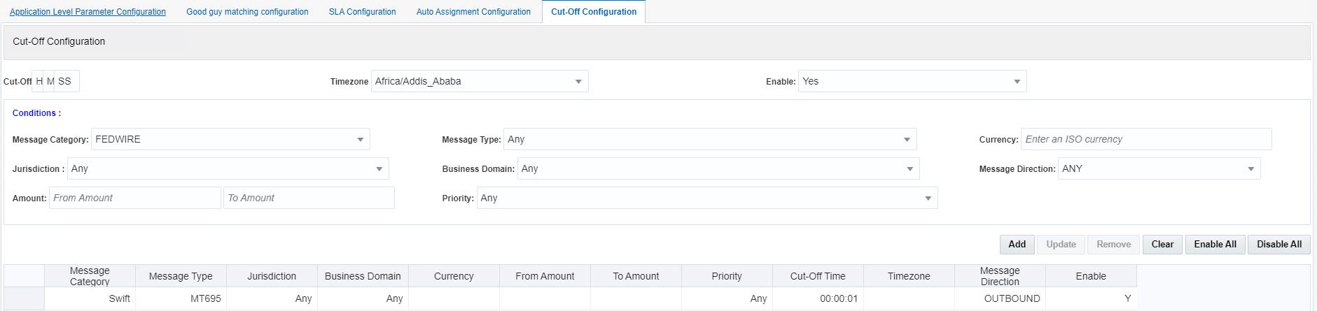

Figure 5-6 Cut-Off Configuration Tab
- Enter the cut-off time in HH:MM:SS format. This is the time period by when the alert must be closed by the investigator.
- Enter the locale. The cut-off time is displayed based on your selection.
- Select Yes to enable a specific combination, else select No.
- To create a combination, use the
following conditions. This is an optional step.
- Message Category: Select the message category used for the transaction. You can also select Any to indicate that regardless of the message category, the cut-off time is enabled for the combination. If you select Any, you cannot select a message type.
- Message Types: Select a message type for the message category. You can also select All to indicate that the cut-off time is enabled for all message types.
- Jurisdiction: Select the jurisdiction/geography if the defined cut-off time must apply to only this jurisdiction. You can also select All to select all jurisdictions/geographies.
- Business Domain: Select the business domain if the defined cut-off time must apply to only this business domain. You can also select All to select all business domains.
- Currency: Enter the ISO currency code of the currency used for the transaction.
- Amount: Select the amount range used in the transaction.
- Priority: Set a specific alert priority or select Any to indicate that the alert can have any priority.
- Message Direction: Select INBOUND for transactions that are coming into your account and select OUTBOUND for transactions that are going out of your account. You can also select Any to select any message direction.
