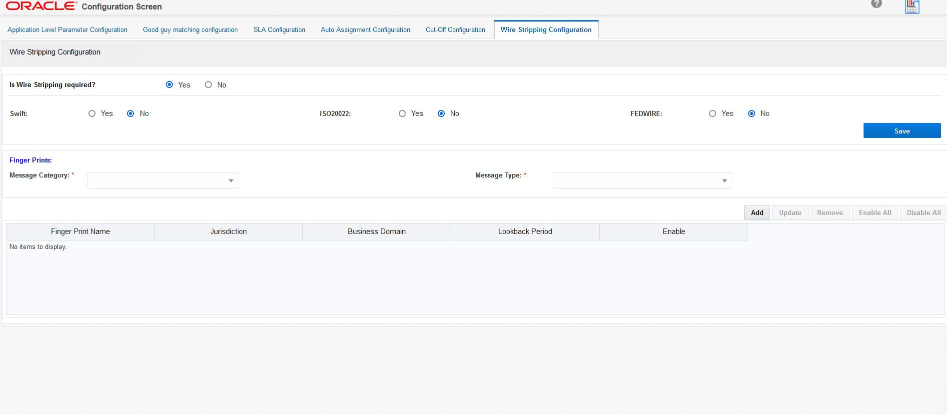

To configure the Fingerprint attributes for the Wire Stripping, follow these steps:
- Navigate to the Financial Services Analytical Applications Transactions Filtering landing page.
- Click Transaction Filtering Admin. The Configuration screen is displayed.
- Click Wire Stripping
Configuration tab.
Figure 5-7 Wire Stripping Configuration Tab
- In the Wire Stripping
configuration section, select Yes if wire stripping is required or
select No
if wire stripping is not required. By default No is selected.
If you select Yes, message category section and Fingerprint sections are enabled.
- Select Yes adjacent to Message Category (Swift, ISO20022 and FEDWIRE) and click Save to add the message category to the fingerprint list. You can add multiple message category to the fin- gerprint.
- In the Fingerprint section, to display
the fingerprint list table select the message category from the Message
Category drop-down list and message type from the Message Type
drop-down list.
The Fingerprint list table displays the results for the combination of message category and mes- sage type that you selected.
To add new fingerprint to the Fingerprint list table click Add. The Add Fingerprint Screen is dis- played.
For information on available message types, see Appendix F: Message Categories and Message Types.
