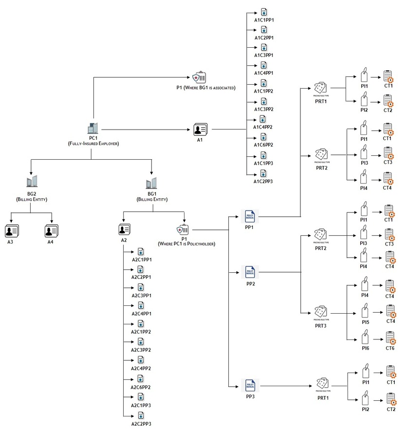

Example 1 - Plan-Specific Contract Creation for a Parent Customer
If a policy plan belongs to a policy of the parent customer (where a bill group is not associated), the system will create one plan-specific contract using each contract type on each account of the parent customer and bill groups. Let us assume that…
PC1 has two bill groups - BG1 and BG2
PC1 has A1 account, BG1 has A2 account, and BG2 has A3 and A4 accounts
A policy named P1 with two plans - PP1 and PP2 - is created for PC1 (where none of the bill groups are associated)
PP1 (with the start date as 01-01-2019) is associated with PRT1 and PRT2
PP2 (with the start date as 03-01-2019) is associated with PRT2 and PRT3
PRT1 contains two price items - PI1 and PI2
PRT2 contains three price items - PI1, PI3, and PI4
PRT3 contains three price items - PI4, PI5, and PI6
PI1 is associated with the CT1 contract type, PI2 is associated with the CT2 contract type, PI3 is associated with the CT3 contract type, PI4 and PI5 are associated with the CT4 contract type, and PI6 is associated with the CT6 contract type
The following table indicates the distinct plan-specific contracts that would be created on the A1, A2, A3, and A4 accounts in the above stated scenario: Account Plan Pricing Rule Type Price Item Contract Type Contract Contract Start Date A1 PP1 PRTI PI1 CT1 A1C1PP1 01-01-2019 PI2 CT2 A1C2PP1 01-01-2019 PRT2 PI1 CT1 A1C1PP1 01-01-2019 PI3 CT3 A1C3PP1 01-01-2019 PI4 CT4 A1C4PP1 01-01-2019 PP2 PRT2 PI1 CT1 A1C1PP2 03-01-2019 PI3 CT3 A1C3PP2 03-01-2019 PI4 CT4 A1C4PP2 03-01-2019 PRT3 PI4 CT4 A1C4PP2 03-01-2019 PI5 CT4 A1C4PP2 03-01-2019 PI6 CT6 A1C6PP2 03-01-2019 A2 PP1 PRTI PI1 CT1 A2C1PP1 01-01-2019 PI2 CT2 A2C2PP1 01-01-2019 PRT2 PI1 CT1 A2C1PP1 01-01-2019 PI3 CT3 A2C3PP1 01-01-2019 PI4 CT4 A2C4PP1 01-01-2019 PP2 PRT2 PI1 CT1 A2C1PP2 03-01-2019 PI3 CT3 A2C3PP2 03-01-2019 PI4 CT4 A2C4PP2 03-01-2019 PRT3 PI4 CT4 A2C4PP2 03-01-2019 PI5 CT4 A2C4PP2 03-01-2019 PI6 CT6 A2C6PP2 03-01-2019 A3 PP1 PRTI PI1 CT1 A3C1PP1 01-01-2019 PI2 CT2 A3C2PP1 01-01-2019 PRT2 PI1 CT1 A3C1PP1 01-01-2019 PI3 CT3 A3C3PP1 01-01-2019 PI4 CT4 A3C4PP1 01-01-2019 PP2 PRT2 PI1 CT1 A3C1PP2 03-01-2019 PI3 CT3 A3C3PP2 03-01-2019 PI4 CT4 A3C4PP2 03-01-2019 PRT3 PI4 CT4 A3C4PP2 03-01-2019 PI5 CT4 A3C4PP2 03-01-2019 PI6 CT6 A3C6PP2 03-01-2019 A4 PP1 PRTI PI1 CT1 A4C1PP1 01-01-2019 PI2 CT2 A4C2PP1 01-01-2019 PRT2 PI1 CT1 A4C1PP1 01-01-2019 PI3 CT3 A4C3PP1 01-01-2019 PI4 CT4 A4C4PP1 01-01-2019 PP2 PRT2 PI1 CT1 A4C1PP2 03-01-2019 PI3 CT3 A4C3PP2 03-01-2019 PI4 CT4 A4C4PP2 03-01-2019 PRT3 PI4 CT4 A4C4PP2 03-01-2019 PI5 CT4 A4C4PP2 03-01-2019 PI6 CT6 A4C6PP2 03-01-2019 The following figure graphically illustrates the example 1:

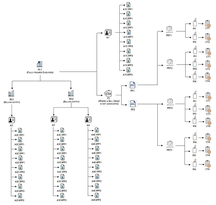

Example 2 - Plan-Specific Contract Creation for a Bill Group
If the policy plan belongs to a policy of a bill group (where the parent customer is the policy holder), the system will create one plan-specific contract using each contract type on each account of the parent customer and the bill group. Let us assume that…
A policy named P1 with three plans - PP1, PP2, and PP3 - is created for BG1 (where PC1 is the policy holder)
PP3 (with the start date as 06-01-2019) is associated with PRT1
The following table indicates the distinct plan-specific contracts that would be created on the A1 and A2 accounts in the above stated scenario: Account Plan Pricing Rule Type Price Item Contract Type Contract Contract Start Date A1 PP1 PRT1 PI1 CT1 A1C1PP1 01-01-2019 PI2 CT2 A1C2PP1 01-01-2019 PRT2 PI1 CT1 A1C1PP1 01-01-2019 PI3 CT3 A1C3PP1 01-01-2019 PI4 CT4 A1C4PP1 01-01-2019 PP2 PRT2 PI1 CT1 A1C1PP2 03-01-2019 PI3 CT3 A1C3PP2 03-01-2019 PI4 CT4 A1C4PP2 03-01-2019 PRT3 PI4 CT4 A1C4PP2 03-01-2019 PI5 CT4 A1C4PP2 03-01-2019 PI6 CT6 A1C6PP2 03-01-2019 PP3 PRT1 PI1 CT1 A1C1PP3 06-01-2019 PI2 CT2 A1C2PP3 06-01-2019 A2 PP1 PRT1 PI1 CT1 A2C1PP1 01-01-2019 PI2 CT2 A2C2PP1 01-01-2019 PRT2 PI1 CT1 A2C1PP1 01-01-2019 PI3 CT3 A2C3PP1 01-01-2019 PI4 CT4 A2C4PP1 01-01-2019 PP2 PRT2 PI1 CT1 A2C1PP2 03-01-2019 PI3 CT3 A2C3PP2 03-01-2019 PI4 CT4 A2C4PP2 03-01-2019 PRT3 PI4 CT4 A2C4PP2 03-01-2019 PI5 CT4 A2C4PP2 03-01-2019 PI6 CT6 A2C6PP2 03-01-2019 PP3 PRT1 PI1 CT1 A2C1PP3 06-01-2019 PI2 CT2 A2C2PP3 06-01-2019 The following figure graphically illustrates the example 2:
Note: The system creates a contract using a contract type for an account when the division to which the account and contract type belongs is same. -

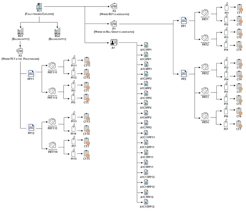

Example 3 - Plan-Specific Contract Creation for an Account of a Parent Customer
If you create an account for a parent customer who holds polices (where a bill group may or may not be associated), the system will create one plan-specific contract using each contract type for all parent customer's policies on the account. Let us assume…
PC1 has two policies - a policy named P1 (where a bill group is not associated) and a policy named P2 (where BG1 is associated)
BG1 has one policy named P2 where PC1 is the policy holder
An account named A1 is added for PC1
P1 has two plans - PP1 and PP2
P2 has two plans - PP11 and PP12
PP2 (with the start date as 06-01-2019) is associated with PRT2, PRT3, and PRT4
PP11 (with the start date as 05-01-2019) is associated with PRT111 and PRT112
PP12 (with the start date as 09-01-2019) is associated with PRT113 and PRT114
PRT2 contains two price items - PI3 and PI4
PRT3 contains two price items - PI1 and PI5
PRT4 contains two price items - PI6 and PI7
PRT111 contains two price items - PI11 and PI12
PRT112 contains two price items - PI1 and PI5
PRT113 contains two price items - PI13 and PI14
PRT114 contains two price items - PI7 and PI15
PI1 is associated with the CT1 contract type, PI2 and PI3 are associated with the CT2 contract type, PI4 is associated with the CT4 contract type, PI5 is associated with the CT5 contract type, PI6 is associated with the CT6 contract type, PI7 is associated with the CT7 contract type, PI11 is associated with the CT11 contract type, PI12 is associated with the CT12 contract type, PI13 is associated with the CT13 contract type, PI14 is associated with the CT14 contract type, and PI15 is associated with the CT15 contract type
The following table indicates the distinct plan-specific contracts that would be created on the A1 account in the above stated scenario: Account Policy Plan Pricing Rule Type Price Item Contract Type Contract Contract Start Date A1 P1 PP1 PRT1 PI1 CT1 A1C1PP1 01-01-2019 PI2 CT2 A1C2PP1 01-01-2019 PRT2 PI3 CT2 A1C2PP1 01-01-2019 PI4 CT4 A1C4PP1 01-01-2019 PP2 PRT2 PI3 CT2 A1C2PP2 06-01-2019 PI4 CT4 A1C4PP2 06-01-2019 PRT3 PI1 CT1 A1C1PP2 06-01-2019 PI5 CT5 A1C5PP2 06-01-2019 PRT4 PI6 CT6 A1C6PP2 06-01-2019 PI7 CT7 A1C7PP2 06-01-2019 P2 PP11 PRT111 PI11 CT11 A1C11PP11 05-01-2019 PI12 CT12 A1C12PP11 05-01-2019 PRT112 PI1 CT1 A1C1PP11 05-01-2019 PI5 CT5 A1C5PP11 05-01-2019 PP12 PRT113 PI13 CT13 A1C13PP12 09-01-2019 PI14 CT14 A1C14PP12 09-01-2019 PRT114 PI7 CT7 A1C7PP12 09-01-2019 PI15 CT15 A1C15PP12 09-01-2019 The following figure graphically illustrates the example 3:

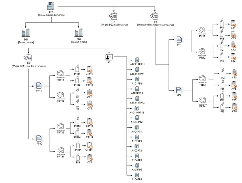

Example 4 - Plan-Specific Contract Creation for an Account of a Bill Group
If you create an account for a bill group who holds policies and its parent customer holds policies (where a bill group may or may not be associated), the system will create one plan-specific contract using each contract type for the bill group's polices and parent customer's polices (where a bill group is not associated) on the account. Let us assume…
PC1 has two policies - a policy named P2 (where a bill group is not associated) and a policy named P1 (where BG2 is associated)
BG2 has one policy named P1 where PC1 is the policy holder
An account named A1 is added for BG2
P1 has two plans - PP11 and PP12
P2 has two plans - PP1 and PP2
PP2 (with the start date as 04-01-2019) is associated with PRT3 and PRT4
PP11 (with the start date as 07-01-2019) is associated with PRT11 and PRT12
PP12 (with the start date as 11-01-2019) is associated with PRT13 and PRT14
PRT2 contains two price items - PI3 and PI2
PRT3 contains two price items - PI3 and PI4
PRT4 contains two price items - PI5 and PI6
PRT11 contains two price items - PI111 and PI112
PRT12 contains two price items - PI1 and PI6
PRT13 contains two price items - PI113 and PI114
PRT14 contains two price items - PI115 and PI5
PI1 is associated with the CT1 contract type, PI2 and PI3 are associated with the CT2 contract type, PI4 is associated with the CT4 contract type, PI5 is associated with the CT5 contract type, PI6 is associated with the CT6 contract type, PI111 is associated with the CT111 contract type, PI112 is associated with the CT112 contract type, PI113 is associated with the CT113 contract type, and PI114 and PI115 is associated with the CT114 contract type
The following table indicates the distinct plan-specific contracts that would be created on the A1 account in the above stated scenario: Account Policy Plan Pricing Rule Type Price Item Contract Type Contract Contract Start Date A1 P1 PP11 PRT11 PI111 CT111 A1C111PP11 07-01-2019 PI112 CT112 A1C112PP11 07-01-2019 PRT12 PI1 CT1 A1C1PP11 07-01-2019 PI6 CT6 A1C6PP11 07-01-2019 PP12 PRT13 PI113 CT113 A1C113PP12 11-01-2019 PI114 CT114 A1C114PP12 11-01-2019 PRT14 PI115 CT114 A1C114PP12 11-01-2019 PI5 CT5 A1C5PP12 11-01-2019 P2 PP1 PRT1 PI1 CT1 A1C1PP1 01-01-2019 PI2 CT2 A1C2PP1 01-01-2019 PRT2 PI2 CT2 A1C2PP1 01-01-2019 PI3 CT2 A1C2PP1 01-01-2019 PP2 PRT3 PI3 CT2 A1C2PP2 04-01-2019 PI4 CT4 A1C4PP2 04-01-2019 PRT4 PI5 CT5 A1C5PP2 04-01-2019 PI6 CT6 A1C6PP2 04-01-2019 The following figure graphically illustrates the example 4:
Note: The system creates a contract using a contract type for an account only when the division to which the account and contract type belongs is same. -
