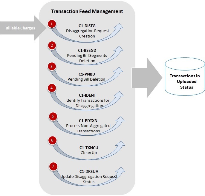

During the transaction disaggregation process, you need to execute the following batches in the specified order:
Disaggregation Request Creation (C1-DISTG)
Pending Bill Segments Deletion (C1-BSEGD)
Pending Bill Deletion (C1-PNBD)
Identify Transactions for Disaggregation (C1-IDENT)
Process Non-Aggregated Transactions (C1-PDTXN)
Clean Up (C1-TXNCU) with the Request Type parameter set to DISAGG
Update Disaggregation Request Status (C1-DRSUA)
The following figure graphically explains the sequence in which you need to execute the batches during the transaction disaggregation process:
