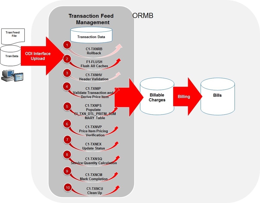

The following figure graphically explains the sequence in which you need to execute the batches during the transaction aggregation process:
