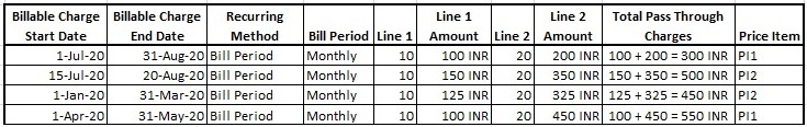

Considers those recurring billable charges with the pass through amount where the usage start or end date falls within the billable charge start and end dates. For example, the system considers the following recurring billable charges of the A1 account:
Derives the final start and end dates for the selected billable charges in the following manner:
Final Start Date = Billable Charge Start Date or Usage Period Start Date whichever is later Final End Date = Billable Charge End Date or Usage Period End Date whichever is earlierThe following table indicates the final start and end dates for the selected billable charges:

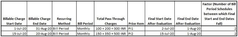

Derives the factor using the final start and end dates and recurring method in the following manner:
Let us assume that the Monthly bill period contains the following schedules:
In such case, the system will derive the factor using the bill period in the following manner:
Multiplies the total pass through charges with the factor, and thereby derives the final pass through charges in the following manner:
Total Recurring Pass Through Charges of PI1 = (300*2) = 600 INR Total Recurring Pass Through Charges of PI2 = (500*2) = 1000 INR -

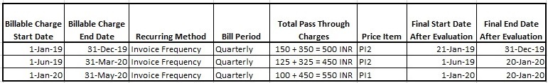

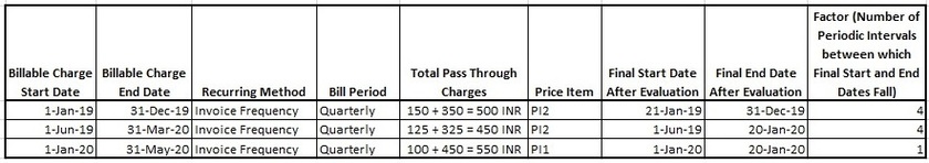

Let us assume that the Quarterly invoice frequency contains the following periodic intervals:
In such case, the system will derive the factor using the invoice frequency in the following manner:
Total Recurring Pass Through Charges of PI1 = (550*1) = 550 INR Total Recurring Pass Through Charges of PI2 = (500*4)+(450*4) = 2000+1800 = 3800 INR -

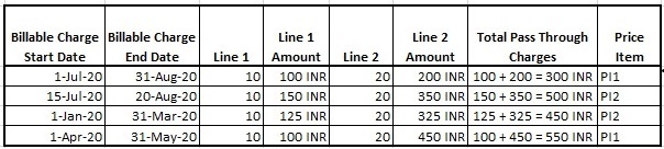

Considers those non-recurring billable charges with the pass through amount where the usage start or end date falls within the billable charge start and end dates. For example, the system considers the following non-recurring billable charges of the A1 account:
Derives the former start date and latter end date of the billable charges in the following manner:
Former Start Date = Compare the Start Dates of All Billable Charges and Reterive the Earliest Start Date Latter End Date = Compare the End Dates of All Billable Charges and Reterive the Latest End DateIn this case, the former start date is 01-Jul-2020 and latter end date is 31-Aug-2020.
Derives the number of months between the former start date and latter end date. In this case, the number of months between 01-Jul-2020 and 31-Aug-2020 is 2.
Derives the monthly non-recurring pass through charges in the following manner:
Monthly Non-Recurring Pass Through Charges of PI1 = Total Non-Recurring Pass Through Charges of PI1/Number of Months between Former Start and Latter End Dates = 300/2 = 150 INR Monthly Non-Recurring Pass Through Charges of PI2 = Total Non-Recurring Pass Through Charges of PI2/Number of Months between Former Start and Latter End Dates = 500/2 = 250 INR -
