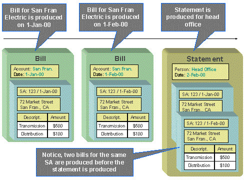

Note: The following diagram illustrates how the above logic could
result in multiple bills for a single contract being linked to the
same statement.
