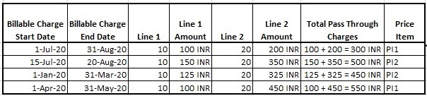

Example 1:
A deal is created for an account named A1 where the deal start date is set to 01-Jul-2020, deal end date is set to 31-Aug-2020, deal currency is set to USD, price selection date is set to 01-Aug-2020, usage period is set to Monthly, and deal frequency is set to Quarterly. Let us assume that the following recurring pass through charges exists for the A1 account where the invoice currency is set to INR:
Now, while calculating the original revenue, the system derives the recurring pass through charges for the usage period in the deal frequency. To derive the recurring pass through charges for the usage period in the deal frequency, the system does the following:

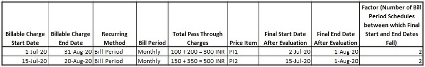

Derives the final start and end dates for the selected billable charges in the following manner:
Final Start Date = Billable Charge Start Date or Usage Period Start Date whichever is later Final End Date = Billable Charge End Date or Usage Period End Date whichever is earlier
The following table indicates the final start and end dates for the selected billable charges:
Derives the factor using the final start and end dates and recurring method in the following manner:
Let us assume that the Monthly bill period contains the following schedules:
In such case, the system will derive the factor using the bill period in the following manner:
Multiplies the total pass through charges with the factor, and thereby derives the final pass through charges in the following manner:
Total Recurring Pass Through Charges of PI1 = (300*2) = 600 INR Total Recurring Pass Through Charges of PI2 = (500*2) = 1000 INR

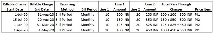

Example 2:
A deal is created for an account named A2 where the deal start date is set to 01-Jan-2020, deal end date is set to 28-Feb-2020, deal currency is set to USD, price selection date is set to 20-Jan-2020, usage period is set to Annually, and deal frequency is set to Quarterly. Let us assume that the following recurring pass through charges exists for the A2 account where the invoice currency is set to EURO:
Derives the usage period (i.e. usage start date and usage end date) using the price selection date and usage frequency in the following manner:
Price Selection Date = 20-Jan-2020 Usage End Date = Price Selection Date = 20-Jan-2020 Usage Start Date = Usage End Date - Usage Frequency = 20-Jan-2020 - 1 Year (i.e. Annually)= 21-Jan-2019 Usage Period = 21-Jan-2019 to 20-Jan-2020
Considers those recurring billable charges with the pass through amount where the usage start or end date falls within the billable charge start and end dates. For example, the system considers the following recurring billable charges of the A2 account:

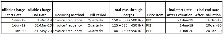

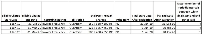

Let us assume that the Quarterly invoice frequency contains the following periodic intervals:
In such case, the system will derive the factor using the invoice frequency in the following manner:
Total Recurring Pass Through Charges of PI1 = (550*1) = 550 INR Total Recurring Pass Through Charges of PI2 = (500*4)+(450*4) = 2000+1800 = 3800 INR
