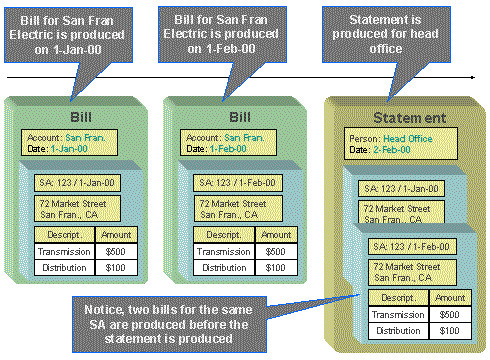

The following diagram illustrates how the above logic could result in multiple bills for a single contract being linked to the same statement.
The figure illustrates an example wherein multiple bills of an account are included in a statement.
