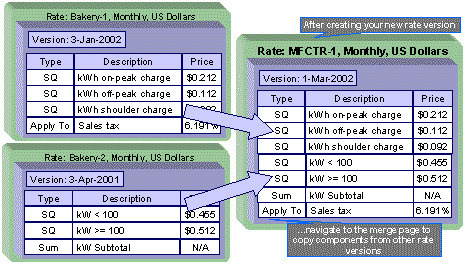

The figure illustrates an example how the data from different rate versions can be merged and thereby create a new rate version using the existing rate versions.
