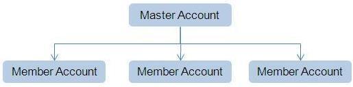

The following figure is a graphical representation of an invoicing group:
The figure illustrates an example of an invoicing group.
