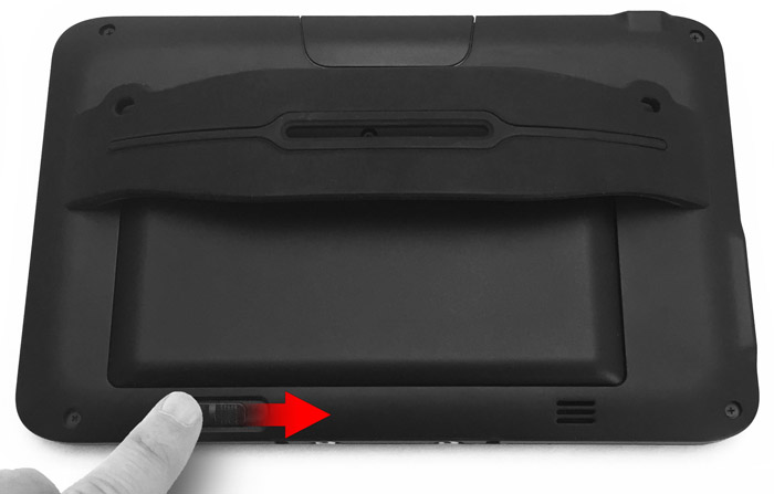

Slide the battery release latch until the main battery detaches from the tablet body. Set the main battery aside.
Figure 6-5 Removing the MICROS Tablet 720 Main Battery

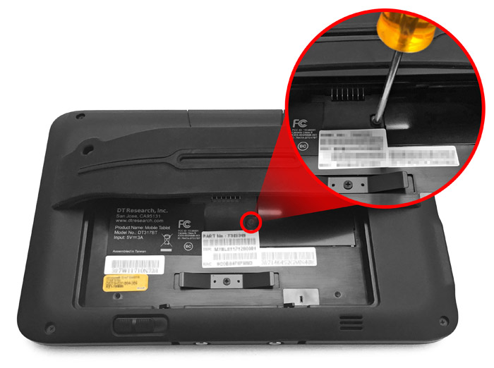

Remove the bridge battery cover using a #1 Phillips screwdriver. For some tablets, you may need to peel back the license decal first.

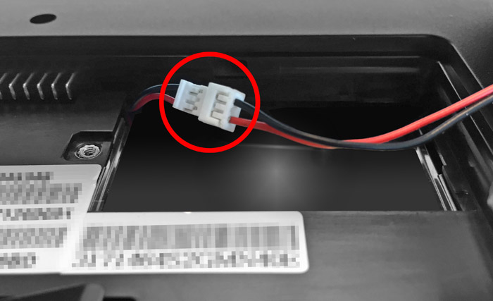

Carefully remove the battery from the compartment until you can access the connector cable. Use your fingers or a gripping tool to carefully separate the connector. Make sure you hold and pull the plastic connectors and not the wires. After disconnecting the battery, set it aside.
Figure 6-7 Battery Connector Cable

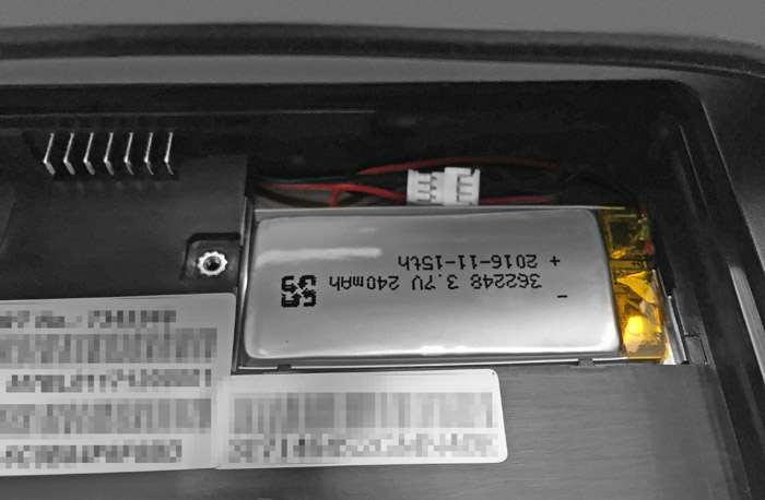

Connect the replacement battery. Tuck the excess battery wire into the casework and place the battery in the battery compartment.
Figure 6-8 The Bridge Battery in the Battery Compartment
