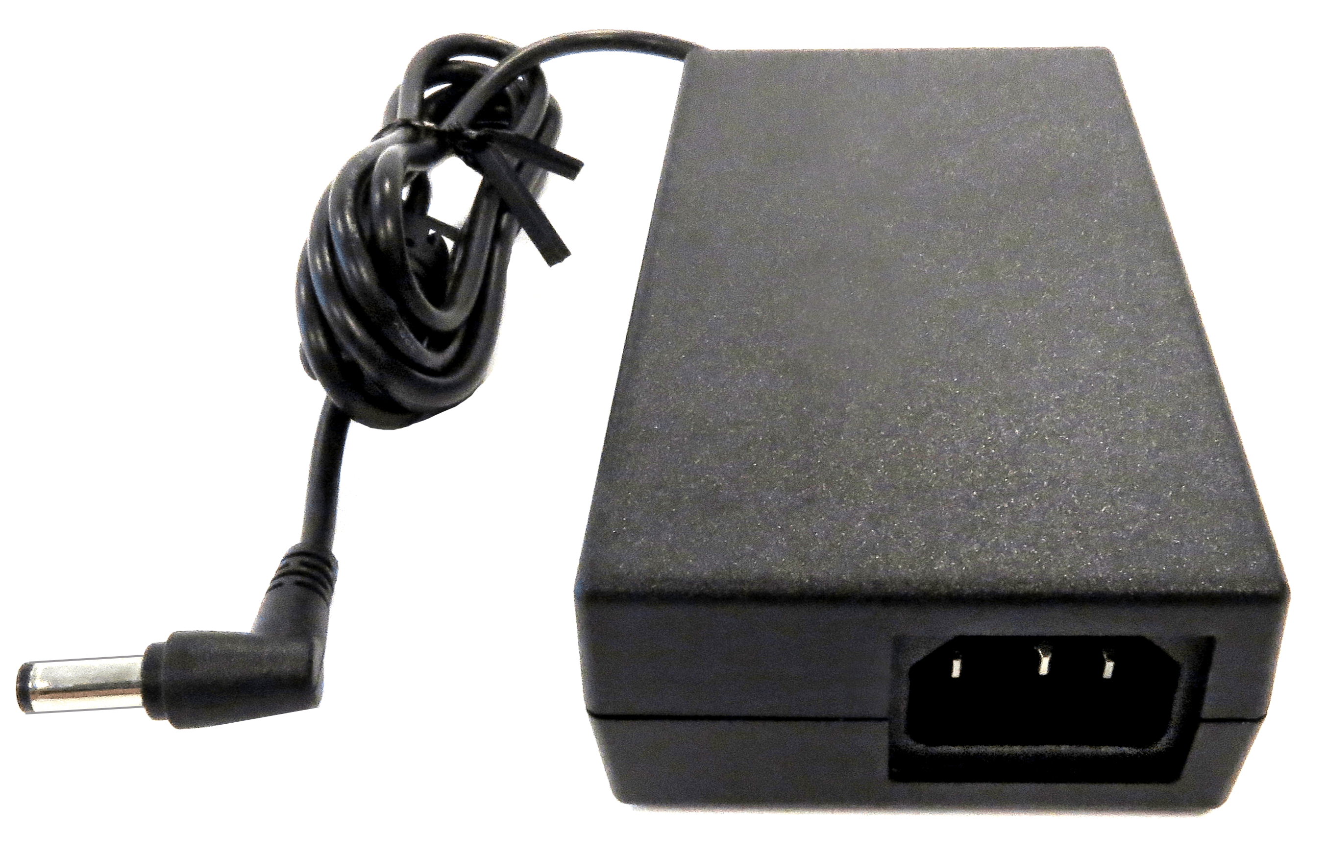

Power Supply Part Number: 7118431 with C13 power cord connection.
The Power Supply (12V) is used to charge a single Tablet 721/721P with the battery attached. Not for use with the Tablet 720. |

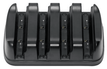

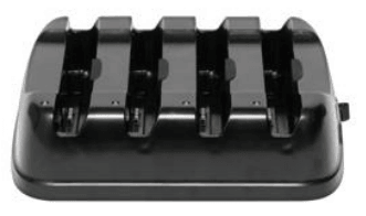

4–Bay Battery Charger Part Number: 7118826 with C13 power cord connection
Charges up to 4 batteries at a time. |

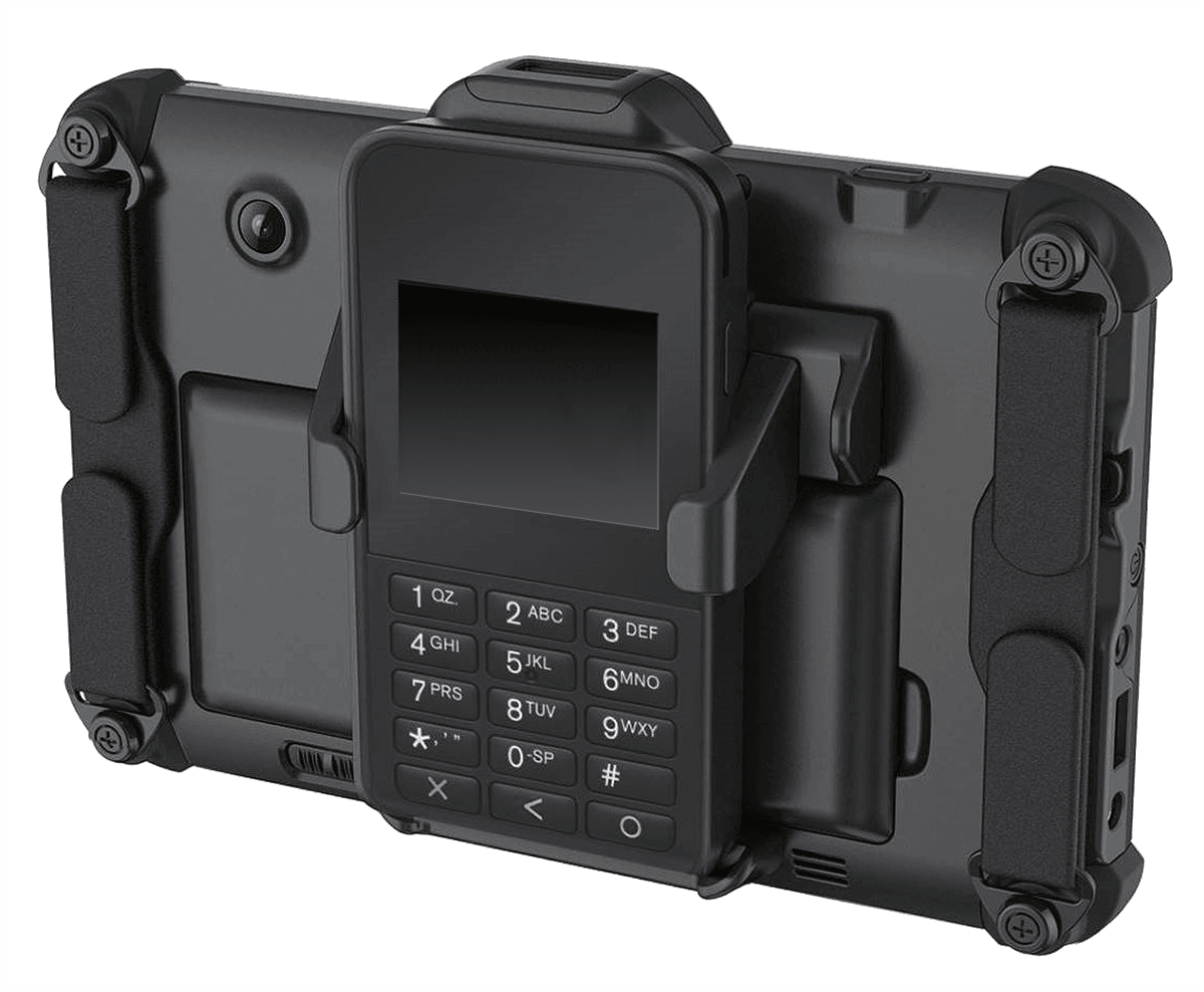

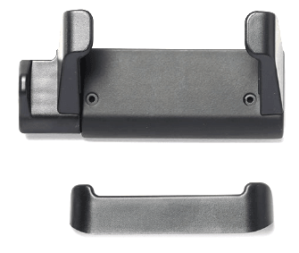

Payment Device Mount and hand straps for Oracle MICROS Tablet 721P Part Number: 7601705
The Payment Device Mount lets you mount a PIN entry device
on the Tablet 721P. |

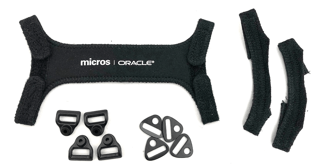

Replacement hand straps and mounting brackets for Oracle MICROS Tablet 721 and Oracle MICROS Tablet 721P Part Number: 7601707
Includes “x-style” and “PED-style” hand straps, plus brackets, screws, and washers for replacing the hand straps on a Tablet 721/721P. |

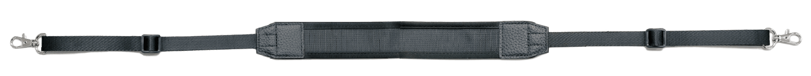

Adjustable Shoulder Straps Part Number: 7605101
Features adjustable length from 50 inches to 67 inches. Sold in packs of 4 and compatible with the Tablet 721P (not compatible with models Tablet 720 or 721). |
