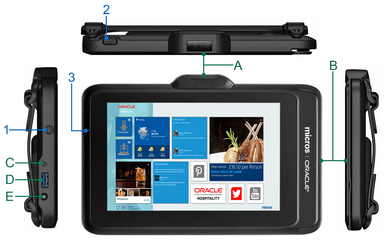

Figure 6-3 The Features of the Oracle MICROS Tablet 721 — Front and Side View

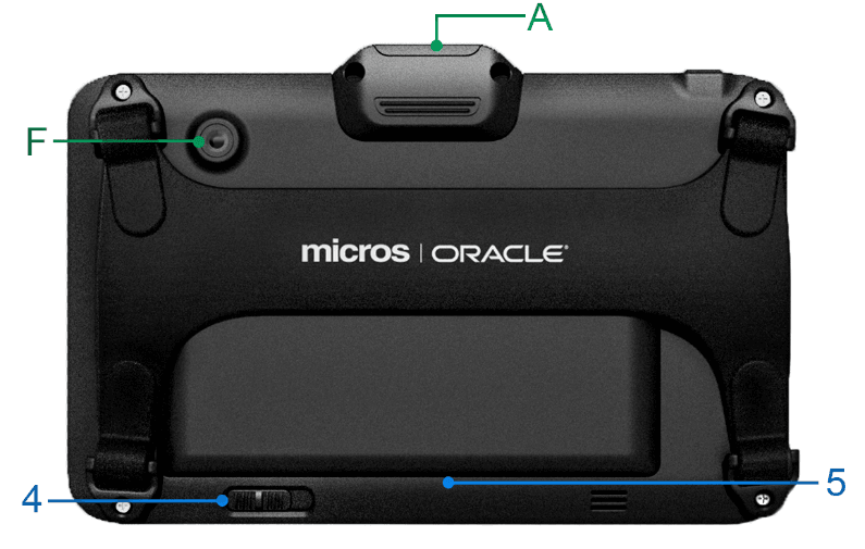

Figure 6-4 The Features of the Oracle MICROS Tablet 721 — Back View
Table 6-5 Input/Output Port on the Oracle MICROS Tablet 721/721P
| Feature | Description |
A. Barcode Scanner (Optional) |
Captures and reads information contained in a bar code. |
B. Magnetic Stripe Reader (MSR) |
Reads magnetic stripe cards for employee sign in, authorization, and loyalty programs. |
C. Headphone Jack |
Use to connect a headphone, a microphone, or a headset. |
D. USB Port |
Use to connect peripherals such as storage devices, printers, and displays. |
E. 12V DC Power Input |
Use to connect a power supply to provide power to your tablet and charge the battery. |
F. Camera |
Use to take photographs. |
Table 6-6 Button Functions on the Oracle MICROS Tablet 721/721P
1. Power Button |
Turns the tablet on or off. |
2. Scanner Trigger |
Use to activate the barcode scanner. |
3. Battery/Power LED |
Indicates the power and battery status. Battery LED Status has more information on the behavior of the LED. |
4. Battery Latch |
Use to unlock and remove the battery. |
5. Battery Sensor |
Senses the presence of a battery. Located in the battery compartment under the battery. Inadvertently pressing this when the battery is removed disables the “hot swap” capability and causes the tablet to power off. |
