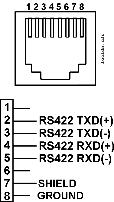

Port Configured for driving RS422 IDN Devices – IDN (+)
The figure below shows the pin configuration of this port when driving IDN devices.
Figure 33-1 IDN or RS422-A/B Connectors Configured for IDN Printing

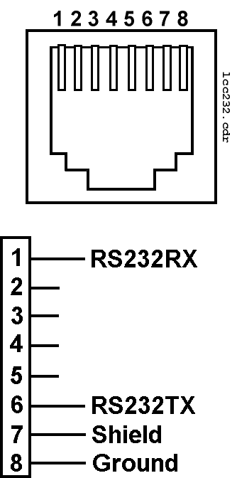

Port Configured for RS232 Devices
The figure below shows the multifunction modular port(s) configured as a basic RS232 Interface.
Figure 33-2 IDN or RS422-A/B Connectors Configured for RS232
