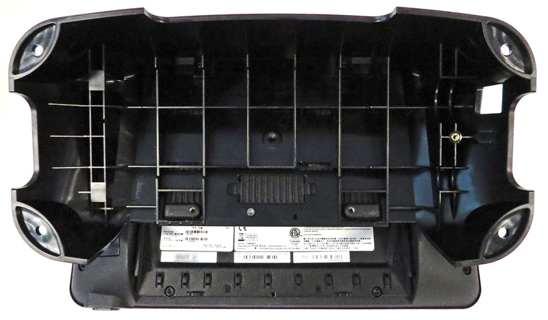

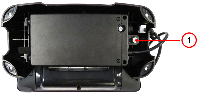

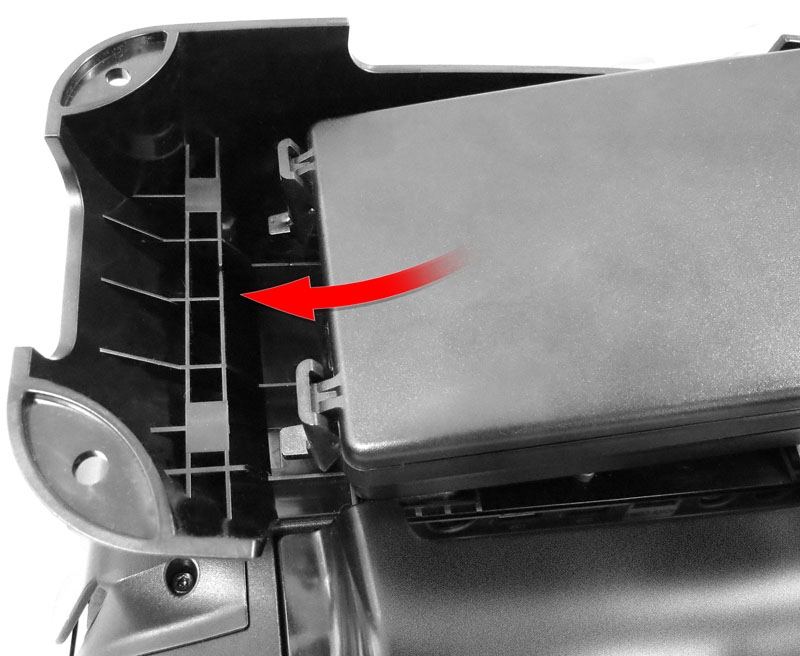

Mounting the Battery Enclosure on the Basic Stand Mounting the Enclosure on a Basic Stand Place the stand and workstation upside down on a flat surface. Insert the enclosure mounting tabs into the stand mounting slots. Tighten the stand thumbscrew (1) to secure the enclosure to the stand. Connect the workstation Power Adapter (15V) to the DC power input, and then plug the Power Adapter into an outlet to charge the battery.
