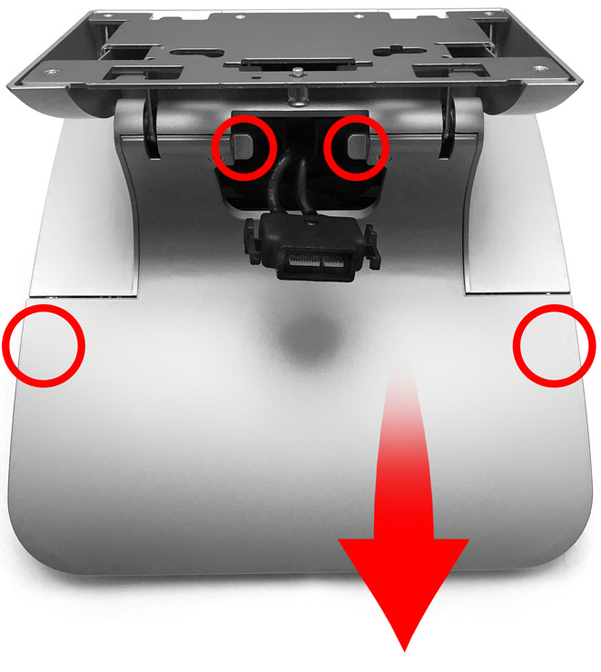

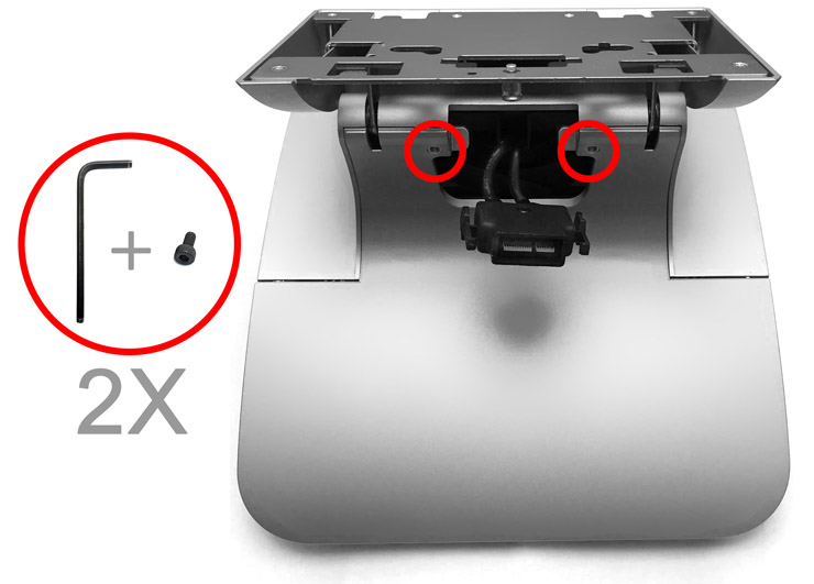

Removing the Adjustable Stand Cover Removing the adjustable stand cover is a common procedure used when setting up any configuration of the Workstation 6 Series. Place the adjustable stand on a flat surface. If you attached the security hex bolts to the cover, remove them using the hex key. Use the front tabs and the edges to pop the cover off the Adjustable Stand. You can detach the cover by rotating it toward you and sliding it forward.
