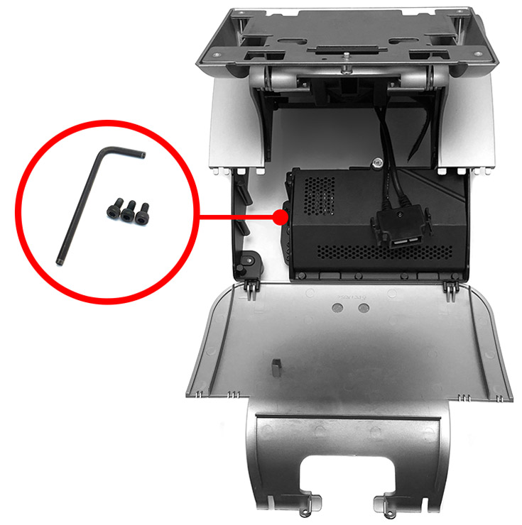

Locating the Hex Key and Security Hex Bolts The hex key and security hex bolts are necessary for several procedures when setting up any configuration of the Workstation 6 Series. Place the Adjustable Stand on a flat surface. Remove the Adjustable Stand cover. Retrieve the spare 2.5mm hex key and the three M3x6 security hex bolts.
