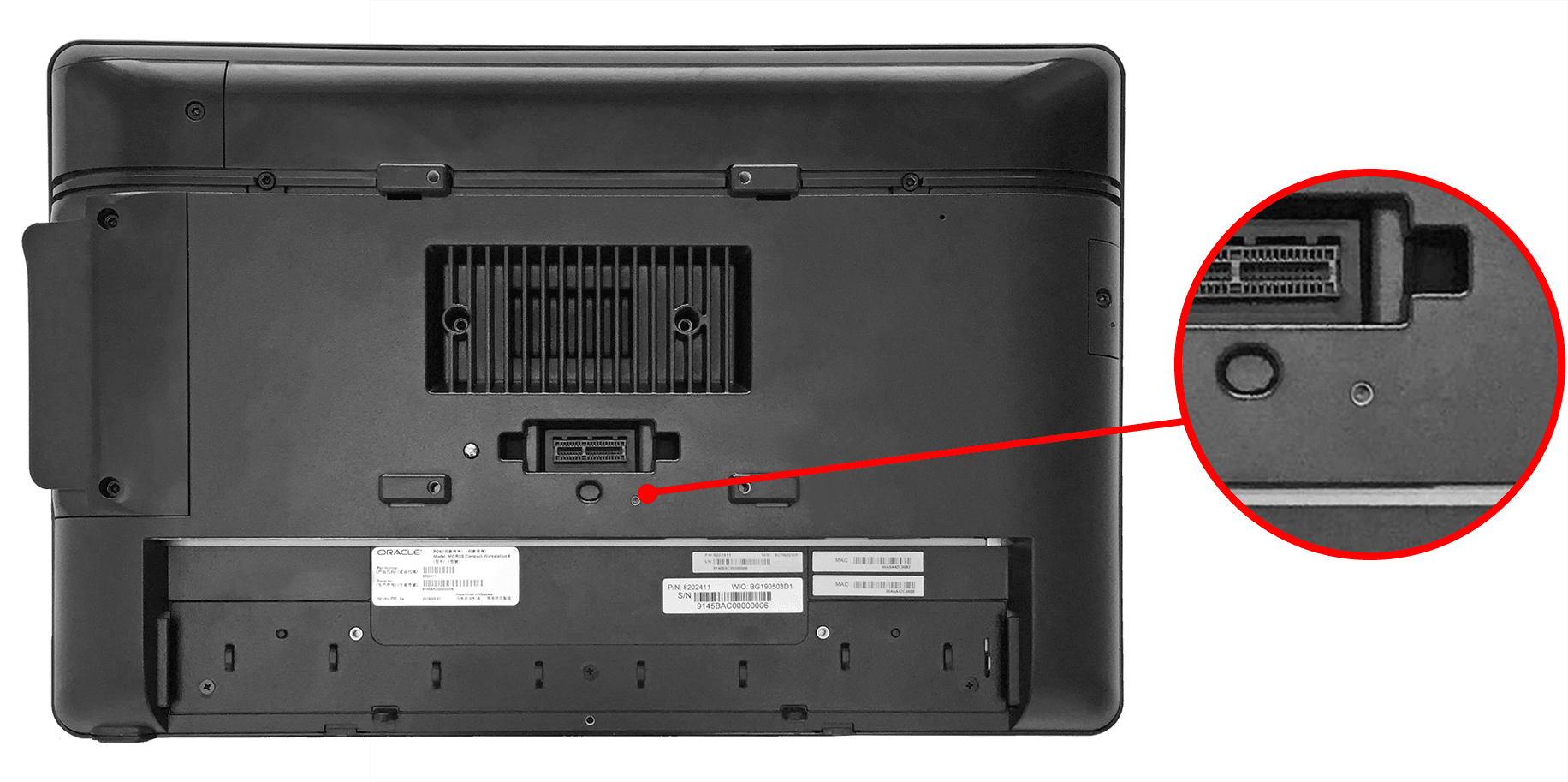

- Locate the recovery button on the back of the workstation,
as shown in the following image.
- Press the recovery button using any object less than 2mm in diameter. You can access the button on the workstation by using an opening on the adjustable stand mount near the DC power cable. Make sure you are not using the opening for the security screw.
