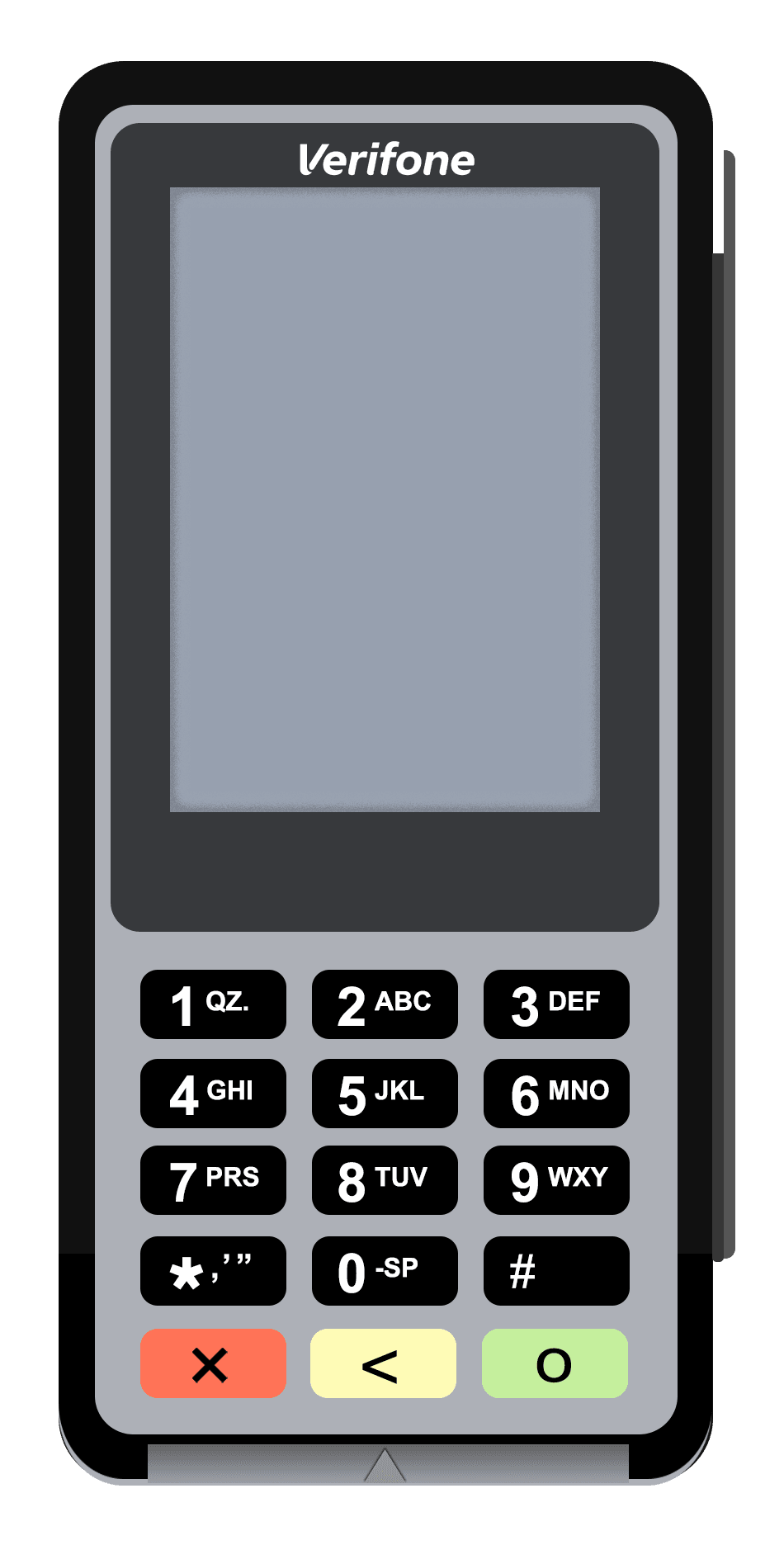

This image shows the Verifone P400 payment terminal with a screen and numbered buttons.
