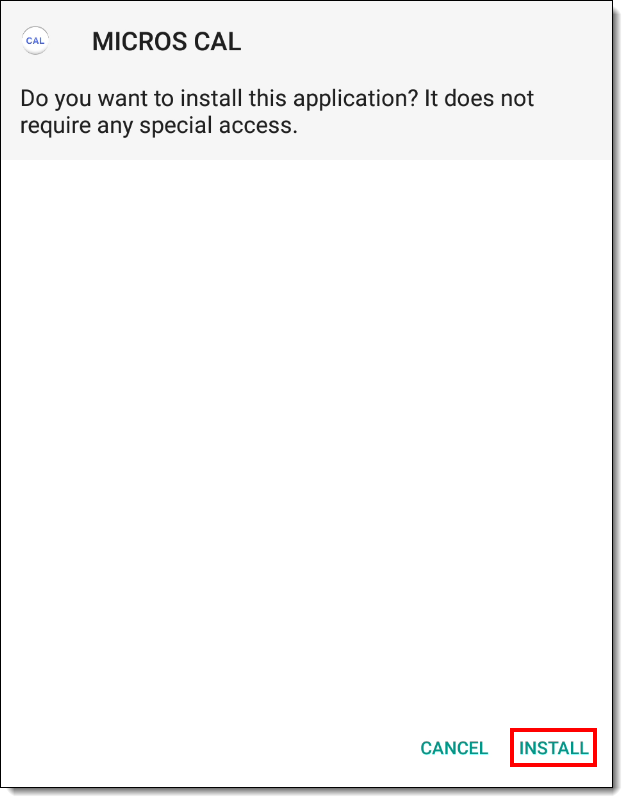

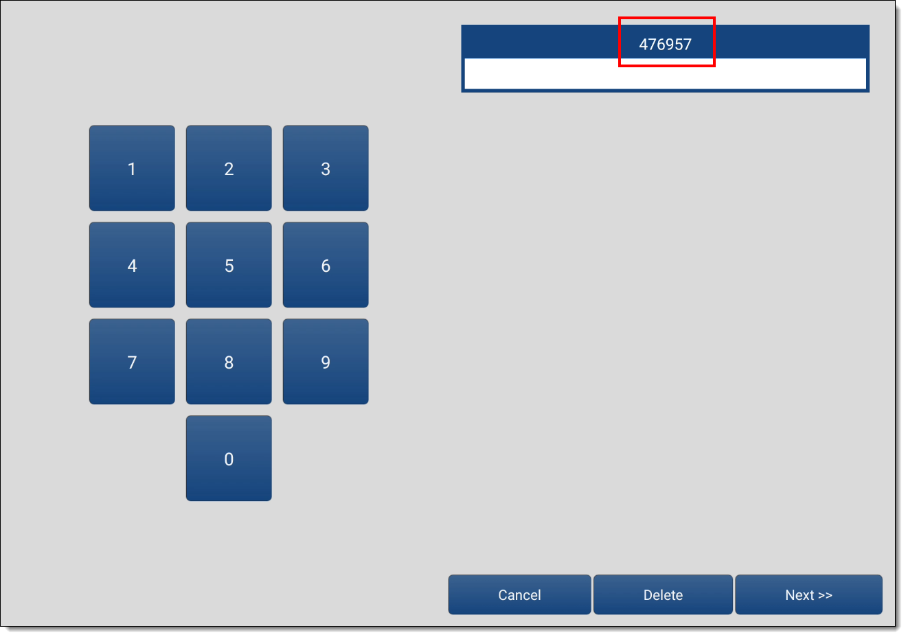

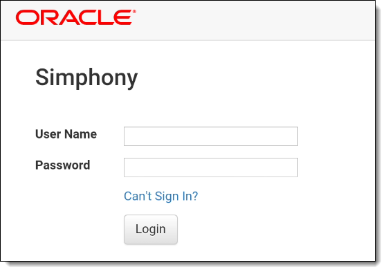

- To initiate a CAL installation on an Android device with
Simphony version 18.2 or later:

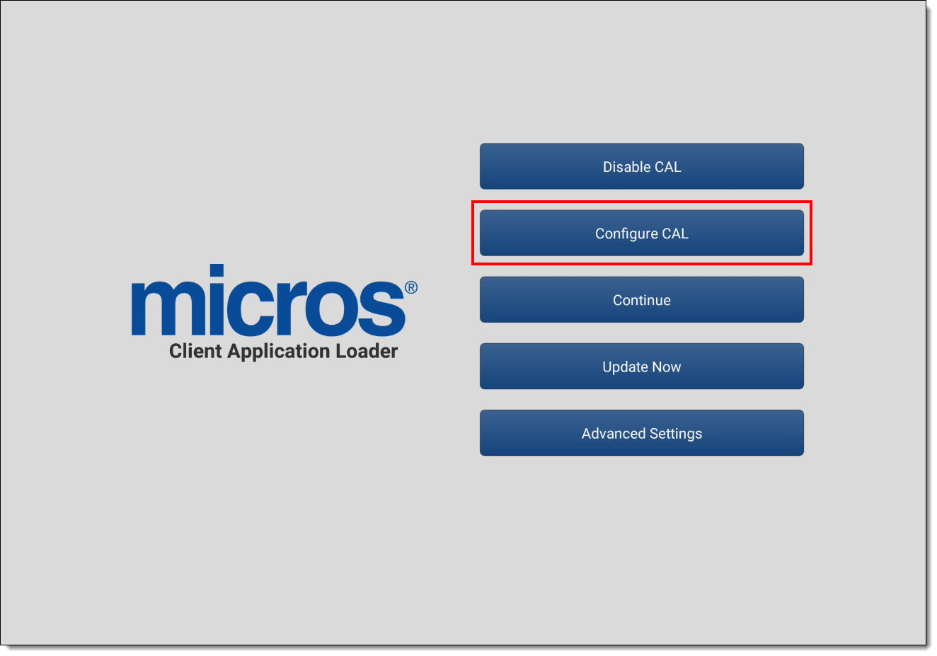

- To initiate CAL configuration on an Android device:
