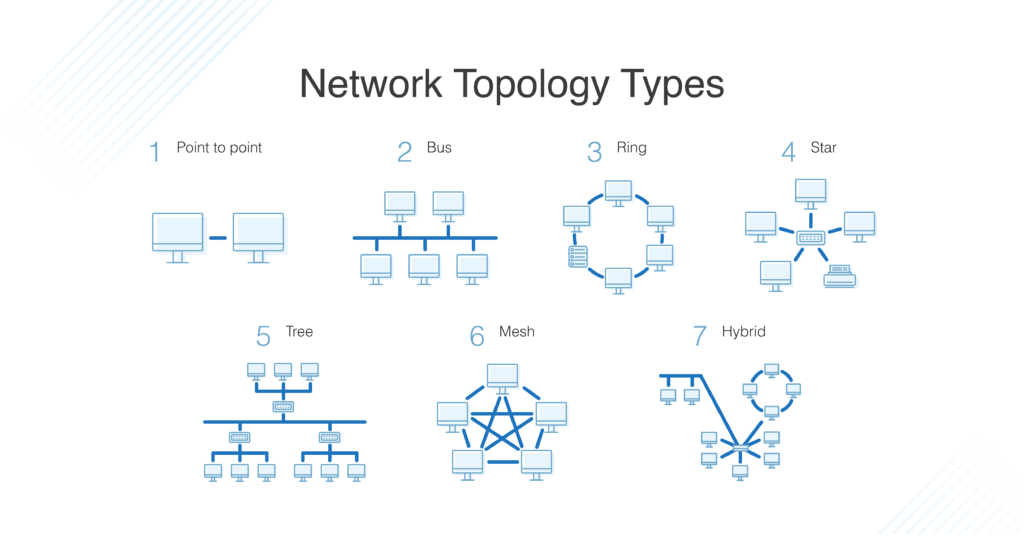

LAN Topologies
  • Point to point
  • Bus
  • Ring
  • Star
  • Tree
  • Mesh
  • Hybrid
This figure shows the network topology types in diagrams: point to point, bus, ring, star, tree, mesh, and hybrid.
