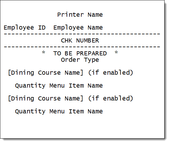

For easier recognition, pre-production chits are formatted differently than conventional order output to remote printers. The text * TO BE PREPARED * prints by default on each chit (with the Order Type shown directly beneath it), before the Dining Course name (if enabled), and then the quantity ordered is printed adjacent to each ordered menu item.

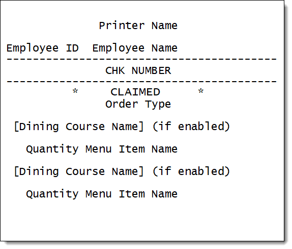

When option 70 - Enable Hold and Fire is enabled in the RVC Parameters module and a check (or menu item) is held, once the check is picked up, the text * CLAIMED * prints on the chit. When the Hold and Fire option is disabled, the * CLAIMED * banner does not print on pre-production chits.

Figure 31-1 Example of a ‘TO BE PREPARED’ Pre-Production Chit
This figure shows an example of a printed ‘TO BE PREPARED’ pre-production order chit.
Figure 31-2 Example of a ‘CLAIMED’ Pre-Production Chit
This figure shows an example of a printed ‘CLAIMED’ pre-production order chit.
