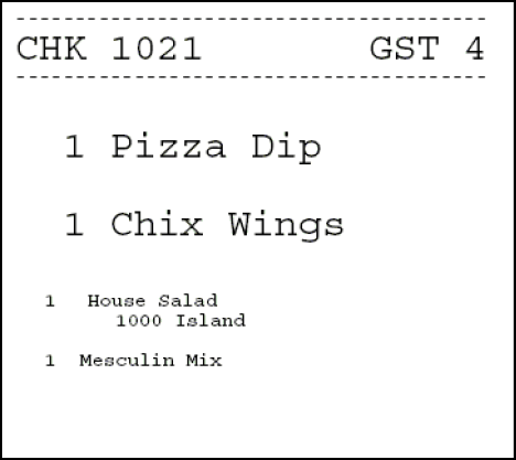

Secondary items print in a smaller font at the bottom of the order chit.
Figure 28-1 Example Order Chit with Secondary Items
This figure shows an example image of an order chit which has the primary items printed on top followed by secondary items in a smaller font at the bottom of the chit.
