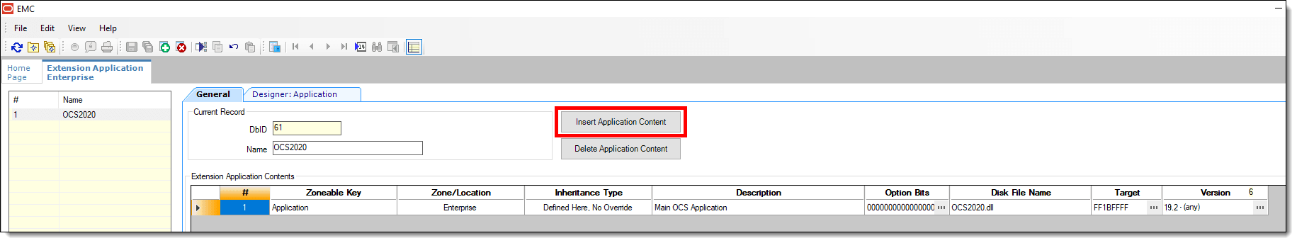

Configuring the Extension Application
  1. Select the Enterprise or property, click Setup, and then click Extension Application.
  2. Insert a new record and name it OCS2020. Toggle to Form view.
  3. On the General tab, click the Insert Application Content button.
    Figure 8-4 Extension Application Module
    This figure shows the EMC’s Extension Application module with the Insert Application Content button outlined in red.

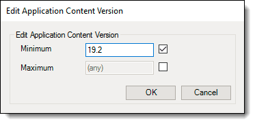

  10. Enter the appropriate Simphony Minimum / Maximum version information in the Version field. Click the ellipsis (…), select the check box adjacent to the minimum version number, and (in this example), enter 19.2 in the Minimum field, and then click OK.
    Figure 8-5 Edit Application Content Version Window
    This figure shows the Extension Application minimum and maximum Simphony version configuration window.
