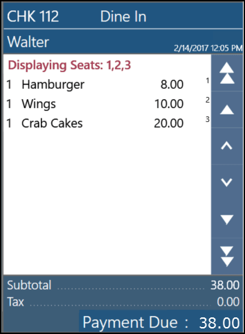

Print checks for one or more seats, or for groups of seats in a large party without creating separate checks
Filter the check by seats 1 and 2.
Apply a tender and close the check for the filtered seats.
If configured, print a memo check.
Close the check by tendering the remaining seats.
After applying a tender to a filtered check, items belonging to the filtered seat or seats are removed from the primary guest check.
The check for the filtered seats is referred to as a memo check. After closing a memo check, depending on the configuration, the active seat in the filter increments to the next seat number, and menu items associated with that seat appear in the check detail area. A memo tendered check contains the same information as the primary check when closed, such as service team details, event details, and suite owner details.

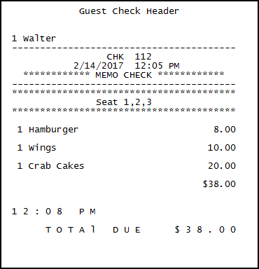

You can identify memo checks on the Check Journal Report by the MEMO CHECK banner on the check header and in ad-hoc reports, as well as on the printed check.
Figure 3-3 Sample Check Filtered by Seats
Figure 3-4 Sample Printed Memo Check
If you print a memo check before applying a tender to the filtered seats, the memo check prints with the check number of the primary check. If you print a memo check after applying a tender and closing the check, a new check number is assigned to the check that is closed. This check numbering continues until the last items on the check are tendered, which closes the primary check and retains the number.
