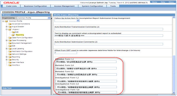

The Expedited reports which are faxed to the PMDA need to be identified by which receiver is sending the information. This is done by the Additional Header information on the report output.
- The following profile switches are added to Console > System
Configuration > Argus J > Reporting. These switches are
specific to the Enterprise:
# Field Label Field Length 1
Marketed: Form 1,2
40
2
Marketed: Form 3,4
40
3
Marketed: Form 5,6
40
4
Investigational: Form 1,2
40
5
Investigational: Form 3,4
40
6
Investigational: Form 5,6
40
These switches are depicted in the following figure:

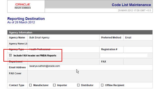

- The Reporting Destination Configuration has an Include FAX Header on PMDA Paper Reports Argus J user-specific check box on the Agency Configuration tab.
- This check box is enabled only when FAX is selected as the Preferred Method and is reset to disabled and blank when Preferred Method is set to something else.
- By default, this field is unchecked for existing and newly created Reporting Destinations.
- You can mark this option for a Reporting Destination and the changes made to this flag are audit logged and printed as part of Codelist Maintenance Print PDF.
- Fax header is printed only if the Include FAX Header on PMDA Paper Reports is marked for that Reporting Destination.

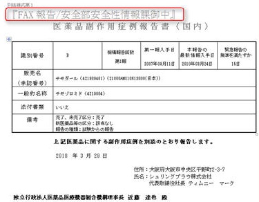

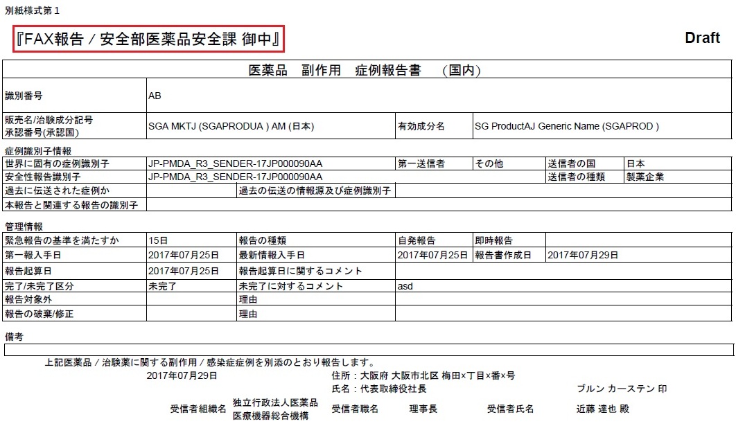

- Text entered in the Common Profile Switch is printed on the first page of the PMDA Paper Report:
- Fax header text is printed in MS Mincho font of size 16.
- Fax header text is printed in the line below the Report Format Number and is aligned to the left.
Figure 4-2 Fax Header in (R2) Paper Report
Figure 4-3 Fax Header in (R3) Paper Report
- If you clear the Fax Header Text for the PMDA Paper reports in the Common Profile
Switch, the header is left blank in the report.

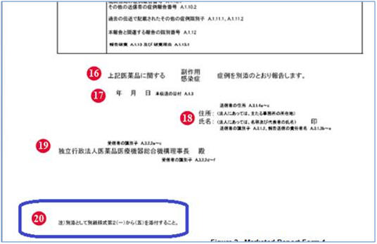

Note printed on PMDA Paper Reports > Marketed Forms 1, 3 and 5 is removed as it is a data entry description (for FAX as well as when sent through Email ) Report Note to be removed (English Translation) Marketed Form 1
Note: Format No.2(1) to (5) have to be attached
Marketed Form 3
Note: Form 4 should be attached together.
Marketed Form 5
Note: Attach Form 6 together.
The following figure depicts the PMDA Paper Report Sample:
