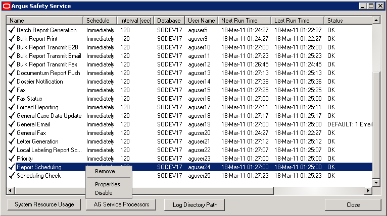

Enable or Disable a Process
Use the following procedure to enable or disable an Argus Safety Service Process.
- Launch the application from Start > Programs > Oracle > Argus Safety Service Configuration.
- The Argus Safety Service dialog displays.
- Right-click any process to Enable or
Disable it.
Disabling a process prevents Oracle Argus Safety Service from running that process when the service is restarted.A disabled process is depicted by a red icon before the Process Name.
