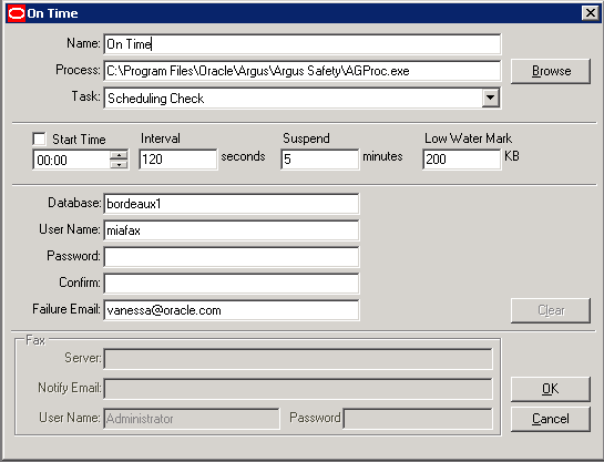

- Right-click the process and select Properties to view the Argus Processes dialog.
- Modify the process details. See Understanding the User Interface.
- Click OK to save your changes to the process.
