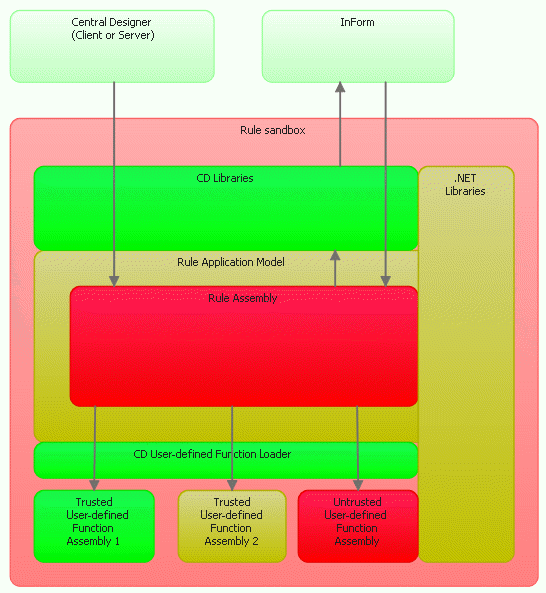

All user-defined function DLLs executed by the Central Designer rule engine run in a sandbox. The rule sandbox is a .NET AppDomain. You can think of it as a light-weight process inside the OS process.
The rule sandbox has the minimum set of permissions possible. This means the permission to execute code (SecurityPermissionFlag.Execution), which is the maximum restriction possible in .NET.
There are two types of user-defined function assemblies:
The following diagram shows the relationship between the sandbox and the main application (InForm or Central Designer), and the assembly structure inside the sandbox.
Color codes:
The two light-green boxes on top represent AppDomains for the main application: Central Designer or InForm. These domains run in full trust. AppDomain technology isolates them from the sandbox. Communication between AppDomains (represented by arrows on the diagrams) is done with remoting calls (inter-process communication or RPCs).
If you follow a call from the Central Designer box to invoke the rule from the rule assembly:
  1. The call is first created in the sandbox.
  2. The call loads Central Designer libraries inside the sandbox and uses a proxy to invoke the method from Central Designer libraries (calls a green code).
  3. The Central Designer libraries load the rule assembly (red code) and invoke the method from the rule assembly.
  4. The rule assembly can make calls through the Rule Application Model into Central Designer libraries (arrow going up).
  5. The rule assembly can make calls through the Rule Application Model into user-defined functions (arrows going down).
Note: The code executed when any of these calls are made is restricted to the set of sandbox permissions. It does not matter if it is trusted or untrusted code, unless trusted code chooses to temporarily elevate the permissions. .NET does not propagate elevated permissions to untrusted code.
