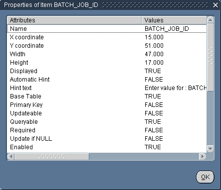

The Field Help box cannot open in Query mode. Many windows in Oracle Clinical open in this mode. You must execute or cancel the query before you invoke field help. Attempts to display the Field Help box in Query mode displays the Properties of Item Window. The information in this window is not related to online help.Parent topic: Getting Help
Query mode prevents the system from launching help properly. If you start a query, then invoke Help, Oracle Clinical opens the Properties of Item window instead of the Help window.
When Oracle Clinical displays this window, click OK to close it, then either complete or cancel your query. Once you are out of query mode, help calls work as expected.
