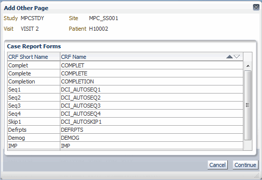

Adding An Other Page
From the Patient Casebooks page, you can add a page to a visit, using CRFs not already planned for the current visit, with the Add Other Page function. The Add Other Page button is active only if you have update privileges.
To add an Other page to a casebook:
- Navigate to the Patient Casebooks page.
- Enter the search criteria for your patient and click Search.
- Click the Visit field and select a visit number from the list.
- Select the check box for your patient.
Click the Add Other Page button. The Add Other Page dialog box opens and lists the CRFs that you can add to the current visit for the selected patient. The dialog box also displays the study and site name.
Select the CRF and then click Continue.
If one or more sub-visits are already added to the visit, RDC Onsite prompts you to select a sub-visit number. Select the sub-visit number and click Continue.
RDC Onsite closes the dialog box and returns to the Patient Casebooks page. If necessary, a new CRF column is added to the spreadsheet. A new, empty CRF icon appears in the appropriate column.
- Click the newly inserted CRF icon to open the CRF in a Data Entry window.
- Enter data and save the CRF.
RDC Onsite numbers the new CRF based on the total number of planned CRFs for the visit, and the existence of other unplanned pages. For example, if the current visit has three planned pages, and you add your first unplanned page with a CRF called AE, after the third CRF, then the system numbers it as 3 U1.
The Add Other Page dialog box lists all CRFs in the Oracle Clinical casebook definition that are checked for unplanned use. The list excludes CRFs planned for the current visit.Parent topic: Adding Pages
