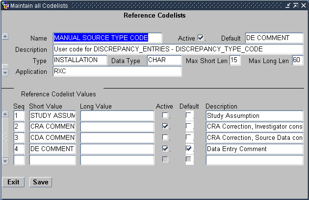

Reason Codes and Descriptions for Manual Discrepancies
When a user creates an Operator Comment (a manual field or section discrepancy in RDC Onsite), the system prompts the user to select a reason code from a list of reasons that is populated by the MANUAL SOURCE TYPE CODE reference codelist in Oracle Clinical. The user can also enter an additional explanation for the discrepancy.
You can add and remove values in the reference codelist (see defining-reason-codes-discrepancies.html#GUID-88BD7ED1-1748-4C50-8D2A-561C6818634E__BABJCAID):
- For each reason you add, enter a value in the Short Value field and the Description field.
- Set one reason to Default. The first time the user creates a manual discrepancy during a login session, the system inserts the default reason. The user can select a different reason. For subsequent manual discrepancies, RDC Onsite displays the last entered reason. The user can always select a different reason.
Oracle Clinical stores the short value in the database.
Table 3-11 Values for MANUAL SOURCE TYPE CODE Reference Codelist

Figure 3-3 Defining Reasons for a Manual Discrepancy
