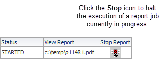

    • Stop Report — Displays a Stop icon that you can click to halt the execution of a report job currently in progress. The Stop icon does not display if the job is complete.

  3. Click the Stop icon in the Stop Report column for the job you want to stop. The Stop Job confirmation dialog box opens.
  4. Click Yes to stop the job. RDC Onsite confirms the action in the confirmation dialog box.
Alternatively, you can click a Job Name link to open another page and view details about the selected report job. If the report job is currently in progress, the page includes a Stop button so you can cancel the generation of the report.

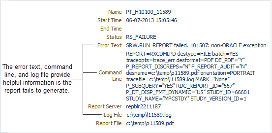

The Reports: Job Details page, as shown in the image below, provides a summary of the job executed. By viewing the details for a report job, you can:
  • View the error text if the job ended in error.
  • View the command line that RDC Onsite sent to the report server.
  • Click a link to open the log file for the report job. Note that RDC Onsite:

  2. Click a link in the Job Name column. As shown in the above image, the Reports: Job Details page displays the following information for the selected job:
    • The job name, and the starting time, ending time, and status of the report generation. The Reports page displays the same information.
    • The error text, the command line executed, and the path name of the log file. You can click the active link to open the log file for the job. This information is helpful when troubleshooting why a report failed to generate.
